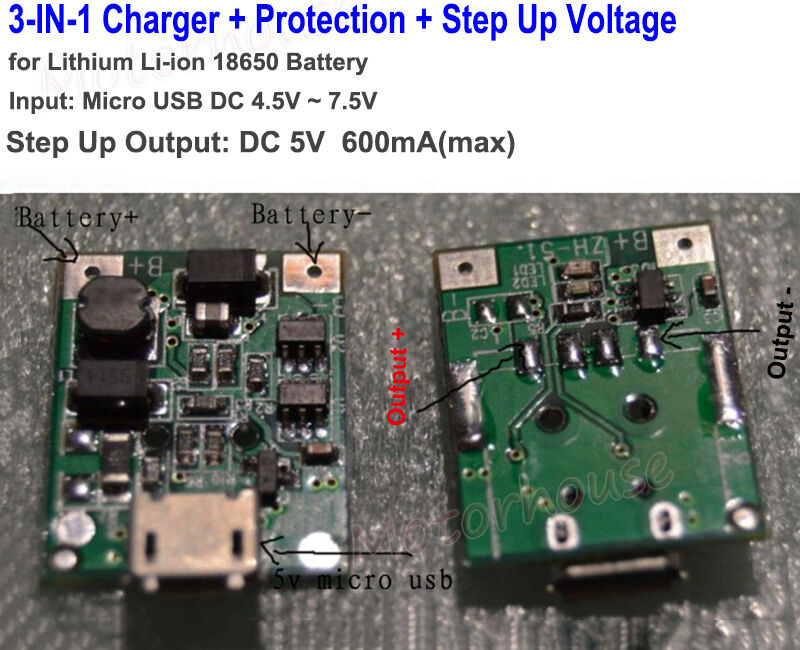

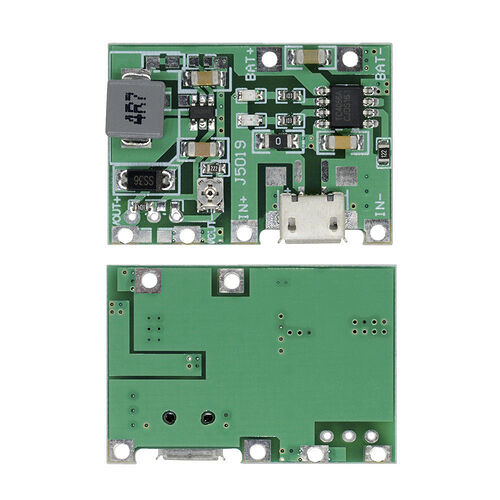

I have found and bought these two 3-in-1 boards which are supposed to provide what I need.
On the paper it all seems good, but I expect to do some testing to see that they behave as expected. If any of you have some experience with these, I would really appreciate to have some feedback.

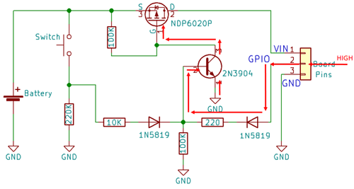

Finally, how do I auto-kill the device once the low voltage is detected? I have learned a bit about latching ciruits, and was thinking about something like this...
This circuit requires the GPIO pin to be set to high at the beginning of the code. And because of the booting time, if the user releases the button earlier, the device will never start. I do not see it necessarily as a bad thing. A sort of an accidental button press protection. But my main question is where should I be fitting this circuit? Initially I though that it would be sitting between my 3-in-1 board, exactly between the 328 and the stepped up voltage. But I am not sure what is the quiescent power consumption of this 3-in-1 board once I kill the actual circuit. The idea would be to cut to zero the power consumption once the low voltage state is detected. The device should just start up, do the battery check, and auto-kill.
The other point I thought of fitting this circuit is between the 3.7 cell and the 3-in-1 board. The problem is what happens then during the charging? I know that mosfets allow current flow only from the source to the drain. So if I put the protective break circuit just after the battery, I won't be able to charge it... Perhaps I can have another parallel mosfet in the opposite direction, which would be turned on by the usb voltage?

Still working on the problem. I made a schematic starting from one made by GreatScott! on youtube. Please, go on the second tab (low part of the canvas) to view the modified version.
Ciruit on EasyEDA
If any of you is willing to point out where I did something stupid, I will really appreciate it.
Thanks :slight_smile:
One thing that was missing from the Great Scott design is something called "load sharing", which allows the USB source to power the load (the boost converter in your case) while charging the battery. Here's a link that explains how this works and provides a schematic.
Without load sharing, battery charging may not terminate properly.

ShermanP:
A Lithium Battery Charger with Load Sharing | Zak's Electronics Blog
Yes. But this is the reason why in the circuit I made there is a power line directly from the charging port, which sets the second gate of the p-mosfet's high, disconnecting the battery and feeding directly the step up converter.
