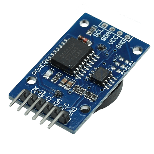

Here's how I did what you said: my project's PCB (Sorry I can't give you the schematic) includes one of these RTC (Real Time Clock) modules:
I power this RTC from an Arduino pin, but only when the Arduino is awake.
The RTC passes GND, VCC, SDA, and SCL through (see the top of the board?), so I connected the fuel gauge's GND, VCC, SDA, SCL from the RTC's similar pins. The battery's + and - are connected to the Fuel Gauge's input (JP1), and thence through JP5 to my project's PCB.
Now I see a huge current draw while sleeping, 800 mA. Whew. Confused, taking a walk. Advice welcome.

Post a wiring diagram of your current setup and post the corresponding code. It seems that your project includes other parts you didn't mention yet. These can influence the power consumption. The RTC probably has internal pull-ups, together with the MAX it might draw current through the protection diodes. So we need complete documentation: schematics of your board and schematics of all external boards. Without this documentation we're just guessing and that's a waste of time.

No. That should not happen as you turn off the gauge completely with my proposed solution. What I say is that it may consume power by the other connected pins depending on the state their in. So even without power on the Vcc pin there might be a consumption in the chip if other pins are powered during the power-off state.
