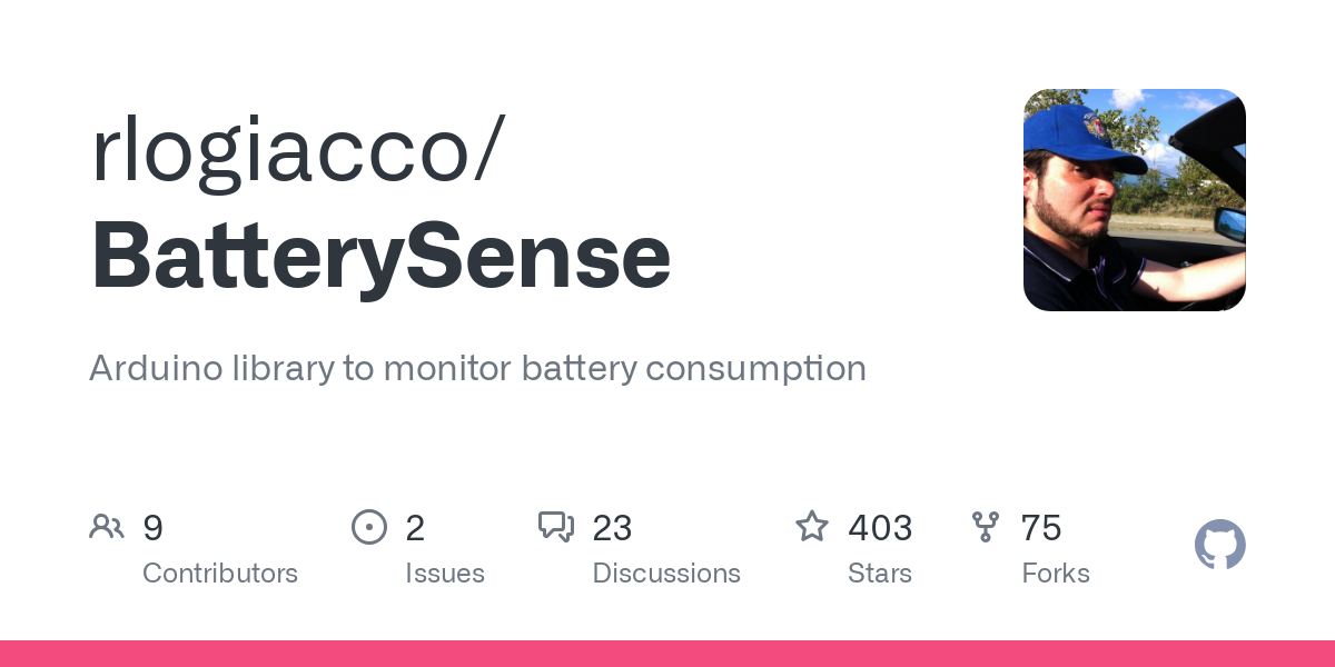

Maybe this library can help you
The above library is a good place to start. It uses a linear model for the battery capacity, which you determine for each battery by conducting a few charge/discharge cycles.
From the library README:
The big assumption here is that battery capacity is linearly correlated to its voltage: the assumption itself is wrong, but in most cases, it's close enough to reality, especially when it comes to the battery's higher capacity side
