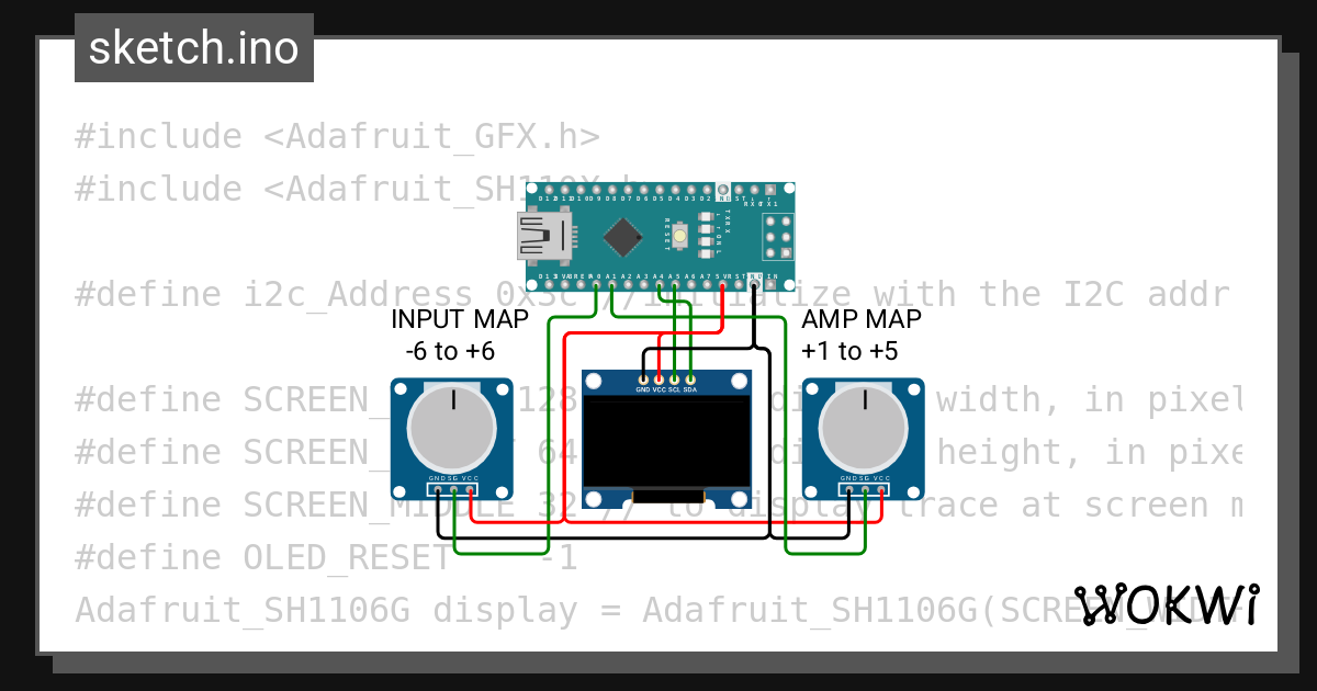

Here is a demo of undrawing and redrawing **graphics** on an OLED.
> **[VFadsr - Wokwi ESP32, STM32, Arduino Simulator](https://wokwi.com/projects/422003525313641473)**
> Run IoT and embedded projects in your browser: ESP32, STM32, Arduino, Pi Pico, and more. No installation required!
