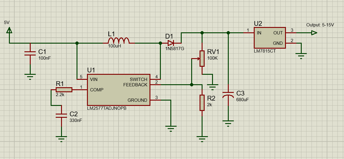

I've been working on a USB 5v to 15v step up converter to use in my projects. Everything works as expected with a pretty stable output but I've been uneasy with how fast the 680uF capacitor charges up when I increase the voltage using the potentiometer, which didn't happen when I used fixed resistors to adjust the feedback pin.
The capacitor starts to whistle and has sparked at least 2 times when I connect its pins to discharge it, I don't know if this is by design since I've been using the circuit shown in the datasheet.
This is the full circuit inclusing the LM7815 regulator

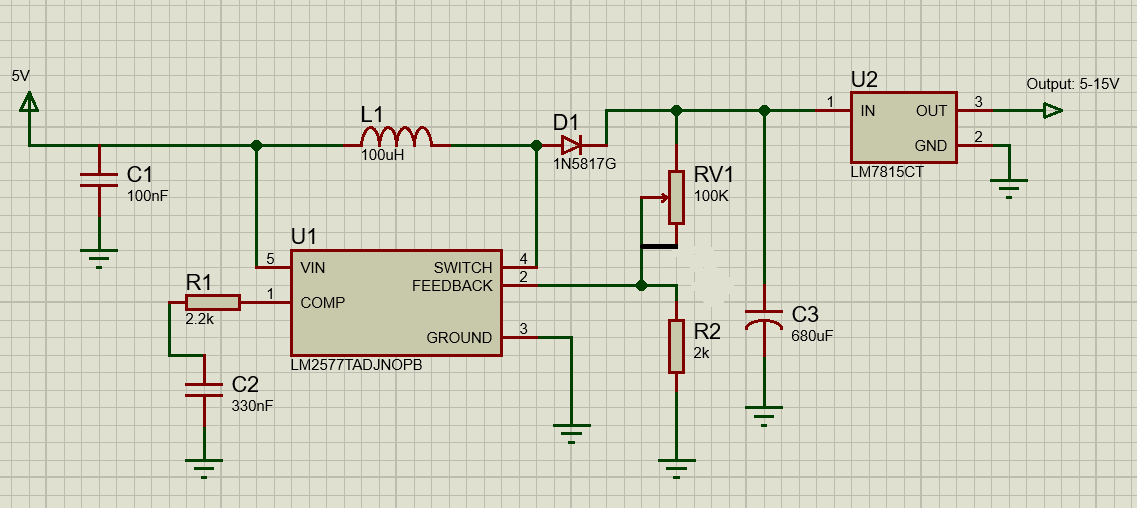

Sounds very bad. Try putting an extra diode between the top of RV1 and C3.
You now have the pot and the 2k resistor in parallel, Why?

Think about this connection. Refer back to the example schematic from the datasheet.

The voltage output is controlled by a voltage divider, so I just replaced R1 with the pot
No you did not. You have changed the circuit. Or your schematic is faulty. You should replace that resistor with a pot with similar resistance.
The example uses a fixed resistor to deliver 12v, replaced it with the pot to adjust it. The ground is connected to the ground pin of the pot and the output is in series with R2. Did I wire it wrong?

By connecting terminal 1 of the pot to ground, you drastically change the nature of the voltage divider.
At worst, the lower resistance is zero Ohms, so it is no longer a divider, with the "feedback" input connected to ground. You have probably cooked C3.
In that case, should I put terminal 1 in series with R2 or just leave it unused?
The pot IS a voltage divider. Either leave out R2 or disconnect pot terminal 1 from ground. In the latter case, choose a smaller value pot (like 25K).

Yes, you wired it wrong.
By tying one end of the pot to ground, instead of leaving it open, what your circuit ends up being is this:
The X portion of the pot is in parallel with R2. Think about what happens when you turn the pot all the way so that the value of X gets close to 0. Look at the equation for determining the output voltage. It's going to increase fast. You may have cooked any or all of L1, D1, C3, U2 and U1.

At least do this change to your project.

Then do something smart around the feedback circuit with a switch that selects between different feedback resistor values. You could potentially control this with a microcontroller, but start with hardware components first.
For the fixed 15V, use a second power supply so that whatever happens with your variable LM2577 circuit won't fry or disturb your 15V supply.
