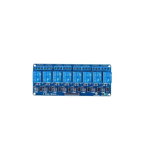

Hmm ok, I guess wiring like this would work?
 ![schematics_try](https://europe1.discourse-cdn.com/arduino/original/4X/5/2/b/52b21394615332ab3aa0549aeae9d0ee4aae7e02.png)
and this is the 5V Relay, I am planning to use:
 ![5v_relay](https://europe1.discourse-cdn.com/arduino/original/4X/0/9/0/090c121887cbcb3ff49f3ca339c628961269296a.png)
> **[1 2 4 8 Channel 5V 12V 10A Relay Module with Optocoupler](https://www.makerlab-electronics.com/products/1-2-4-8-channel-5v-12v-10a-relay-module-with-optocoupler?%5C_pos=1&%5C_sid=18cd08c42&%5C_ss=r&variant=43922027905215%3Fvariant%3D43922027905215)**
> NOTE: Please Select only 5V for Arduino, Orange Pi, and Raspberry PiNOTE: Please Select only 5V for Arduino, Orange Pi, and Raspberry PiNOTE: Please Select only 5V for Arduino, Orange Pi, and Raspberry PiRelays are used to control or switch devices...

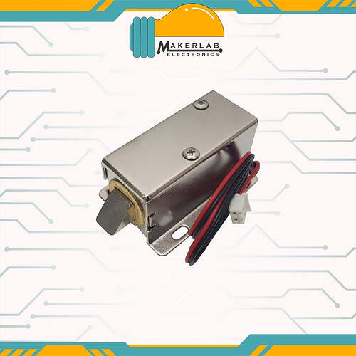

It is this one and I am planning to apply power to the lock for like 5-10 seconds
> **[12V Solenoid Lock Philippines - Makerlab Electronics](https://www.makerlab-electronics.com/products/12v-solenoid-lock?%5C_pos=1&%5C_psq=12v%2Bsolenoid&%5C_ss=e&%5C_v=1.0)**
> Our 12v solenoid lock in particular is strong, has a slug with a slanted cut and a good mounting bracket. It's designed for a basic cabinet or door.

**Post date:** [August 13, 2025, 2:26pm UTC](https://forum.arduino.cc/t/lm2956-buck-converter-12v-and-5v-single-channel-relay/1402061/15 "2025-08-13T14:26:40Z")
</div>
> [@astral420](#):
> It is this one
The description says: "To drive a solenoid lock with an Arduino you will need a relay module fairly good power supply, as a lot of current will rush into the solenoid to charge up the electro-magnet, about 500mA"
So If that 500mA is the inrush current, your power supply is ok.
> [@astral420](#):
If that relay is "low-level trigger type", you shouldn't drive it directly from Esp. Use NPN transistor to drive it or use a relay that has high-level trigger or separate pins for coil .

> [@astral420](#):
Thta's OK but you also need to connect the OUT- to the relay DC- AND the ESP GND
It may or may not work with 3.3V I/O from the ESP
There is not enough information on the webpage.
