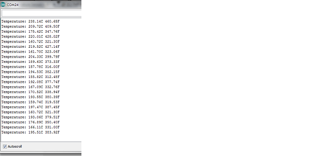

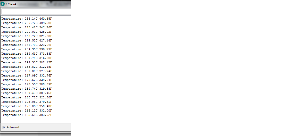

LM35 degrees always wrong
hi,
i connect a Lm35 to my arduino and use this code
but i always get the same nubers in my room is it 25C and its give me much more any help ?
Thnks !!
int analogPin = 0;
int readValue = 0;
float temperature = 0;
float temperatureF = 0;
 readValue = analogRead(analogPin);
 //Serial.println(readValue);
temperature = (readValue * 0.49);
 temperatureF = (temperature * 1.8) + 32;
 Serial.print("Temperature: ");
 Serial.print(temperature);
 Serial.print("C ");
 Serial.print(temperatureF);
 Serial.println("F");
The code can't explain the delta's
How did you connect the sensor? Can you post a drawing?

Try this code
Chuck
This code uses many samples and the internal reference voltage for higher accuracy.
LM35 connected to A1, +5volt, and ground.
Leo..
