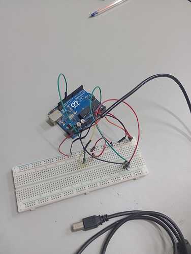

Ds18b20 works but LM35 is unstable (I don't know why). The problem is not the analog (i tried to change to A5). The code looks ok...

Red jumper->5V
Orange jumper->GND
Green jumper(analog)->A0
Green jumper(DS18B20)->12
how unstable? +/- 2-3 points? 0-1023?
i got from AliExpress NPN transistors marked as LM35. Ali Judgement decide "for refund send goods back to China". i closed my account 4 years ago.
Several people have had problems with that sensor when using it on a breadboard.
Many times there is a poor connection inside the breadboard.
You have several wires for connections to ground and 5V, which increases the chance of a bad connection.
Connect the LM35 GND pin directly to the arduino GND using just one wire.
Connect the LM35 +Vs pin directly to the arduino 5V using just one wire.
Connect the LM35 out pin directly to the arduino A0 using just one wire.
Connect a 10uF capacitor directly across the LM35 +Vs pin and gnd pin
Make sure the LM35 feels like it's making a tight connection when you push it into the breadboard.

Change to the following. Also, check that the legs of the sensor are tightly engaged with the contacts of the breadboard.
  unsigned valor_analog_lm35 = analogRead(pin_lm35);
  float tensao = 100*(5/1023.0)*valor_analog_lm35;
  Serial.print ("Temperatura ambiente =  " );
  Serial.println(tensao);
The LM35 has very limited current sink capability. It may take several read cycles to get a stable result if the temperature decreases.

The problem I was describing is the inability to drive the ADC when voltage decreases. This is in addition to the thermal response. The problem is buried in one line on page 13 of the data sheet section 7.1.
Therefore the LM35 can only source current and it's sinking capability is limited to 1 μA.
Why do people think ChatGPT is even worth mentioning?
Looking at the data sheet circuit examples it seems like they use a fairly small (200 ohms in some cases) load resistor. That should sink the higher voltage quite quickly.

That is a LOT of wires to connect to a three terminal device. You havent provided a schematic so we cant see what you have connected and I doint know what the R is for. Or its value.
Or where the thick black cable is going.

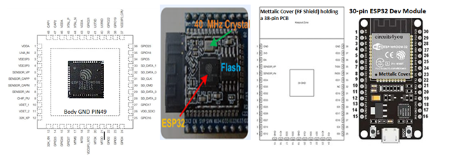

You can just read the chip name on the chips plastic case....
The chip is located underneath the RF Shield (metallic cover) of ESP-WROOM-32 Module.
esp32AllFour
