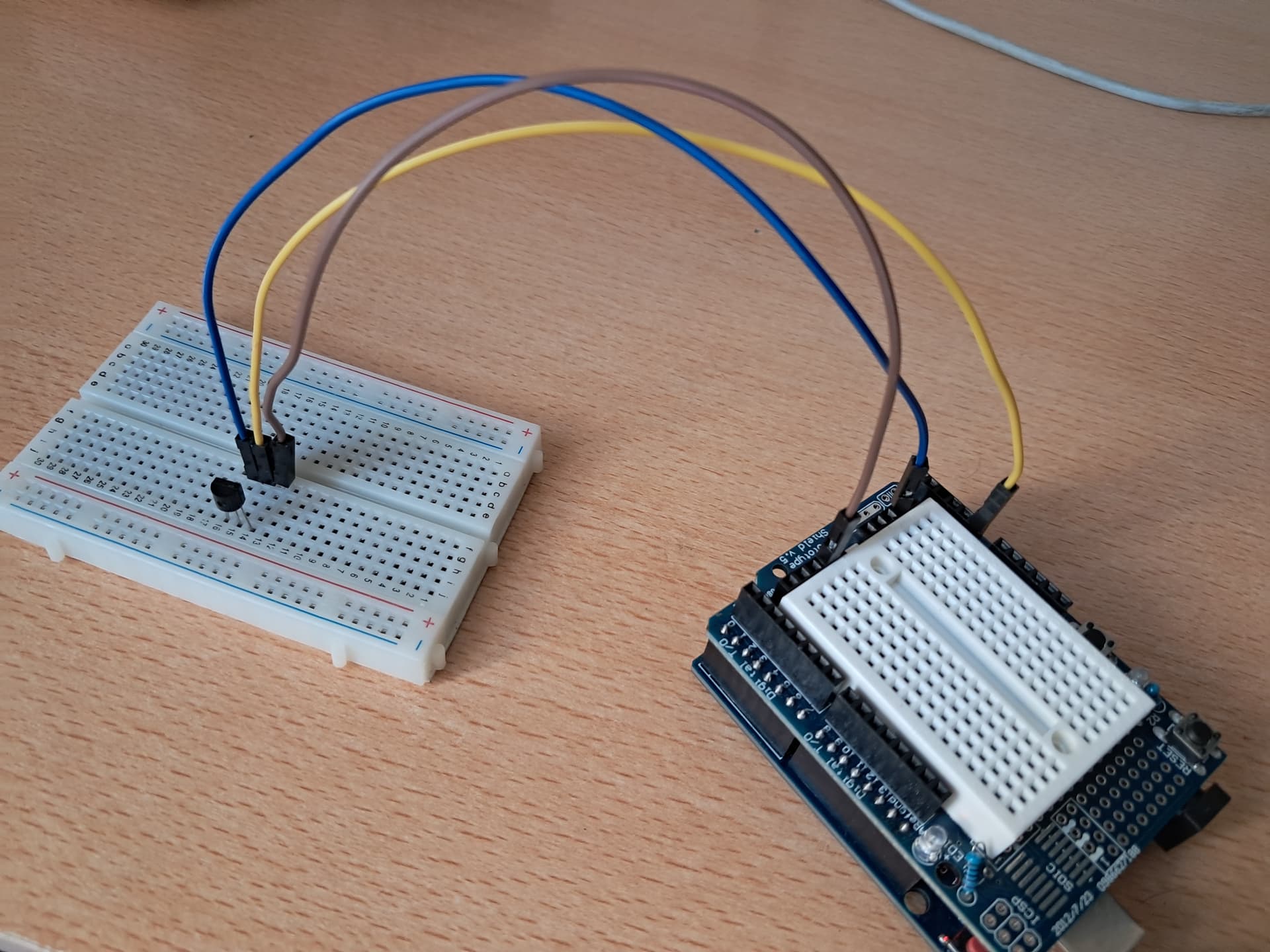

LM35DZ sensor gives 0 value
Hello. I am new to using the LM35DZ sensor and I just unpacked it. I believe I connected the cables correctly. But for some reason the sensor starts to give a value in a certain range and then slowly drops to 0. I have the same problem with 2 LM35DZ sensors that I just unpacked.

Set-up
What am i doing wrong?
Two things: not errors, but opportunities for improvement.
  1. You don't need to configure an analog input pin as INPUT.
  2. Always start at a much higher serial rate and reduce if needed. I suggest 115,200bps
Your code looks fine so it's probably a wiring error. Show a schematic. A photo of what you have done isn't very useful.
To debug, remove shield and plug cables direct to arduino.
