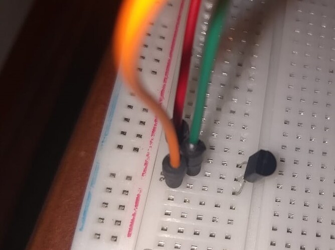

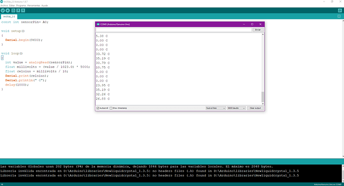

I have a problem with my LM35DZ which show me values that aren't the ones I expected.
I tried different codes and change the PIN but it's still the same.
Here is the code I'm using
float tempC;
int pinLM35 = A1;
  tempC = analogRead(pinLM35);
  Serial.print("Temp before multiplication ");
  Serial.println(tempC);
  tempC = ((5.0 * tempC * 100.0)/1024.0) / 10;
  Serial.print("Temp after multiplication ");
  Serial.print("\n");
And on the image below I show you what I notice
[img]https://imgur.com/AMhQw6H[/img]
The values in the red rectangles are the ones that I think are accurate and the ones in the blue rectangles are those that are confusing me...
(I know that is an equation not just a multiplication, a little mistake there, nothing to do with the problem anyways)
Hope you can help me, thanks in advance

I tried this code. The values drop to zero and I didn't even touch it, I checked the wiring multiple times, it's not that difficult indeed so I'm almost sure that's not the problem
const int sensorPin= A0;
  int value = analogRead(sensorPin);
  float millivolts = (value / 1023.0) * 5000;
  float celsius = millivolts / 10;
  Serial.print(celsius);
  Serial.println(" C");

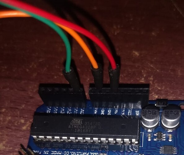

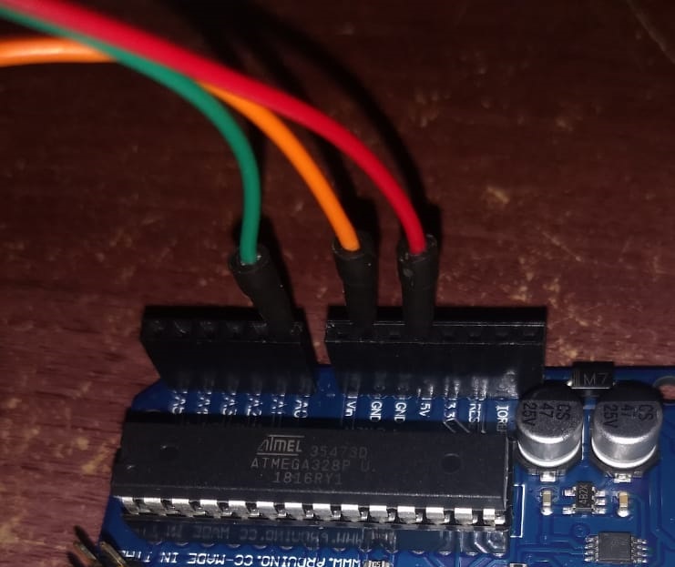

Looks like loose connection to me, are you SURE the LM35 is connected correctly? Datasheet page 3. At room temperature (23C) the ADC value should be around 47.
outsider:
http://www.ti.com/lit/ds/symlink/lm35.pdf
Here it is, I think it's correct.
This is a genuine part, not a knock-off from eBay?
MarkT:
I bought an starter pack for Arduino, all the other stuff seems to work properly, I only have problems with this.
