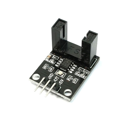

Thanks for your reply. I've used this chasis with an encoder disk and lm393 module to count the pulses and used the interrupts.

LM393 Module
I suspect that the encoder transitions are not clean and sharp, so you get multiple rising edges for each opening of the encoder wheel.
Write a simple program that prints out left_ticks and right_ticks while rotating either wheel by hand, or check the signals with an oscilloscope.
If that is the case, don't use sei() and cli(), and instead learn how to enable/disable the external interrupts. The encoder ticks won't happen very frequently, so inserting a small delay (a few milliseconds) before re-enabling each external interrupts might help.
