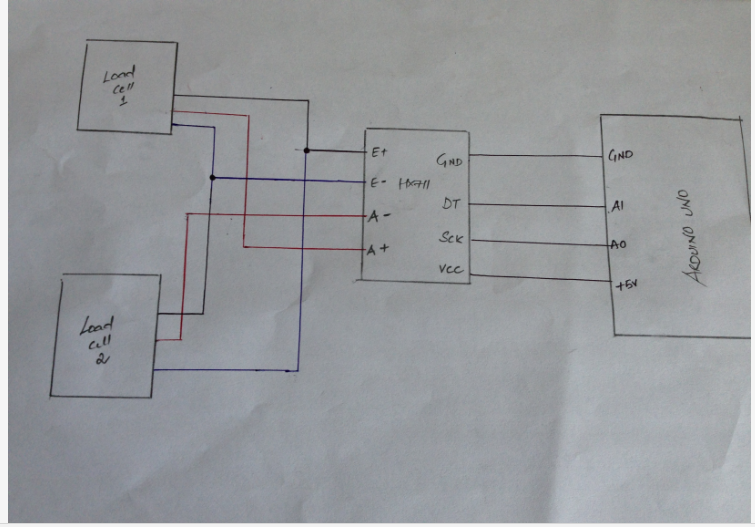

I have two 3 wired load cells (white, red, black) and I'm using them to create a 100 kg scale using HX711 but the connections and the coding given in all the sites are not giving the expected results instead they are printing random values. I've used this HX711 library GitHub - bogde/HX711: An Arduino library to interface the Avia Semiconductor HX711 24-Bit Analog-to-Digital Converter (ADC) for Weight Scales. .Nothing seems to help. I don't know a lot about these cells. Please help. Thank you.
Circuit:Connect HX711 to a three wire load cell
Cell:http://www.amazon.in/3-Wired-Half-Bridge-Electronic-Weighing-Sensor/dp/B00R1J7WTA
Hi, and welcome to the forum.
More information is needed.
Did you connect one or two load cell to the HX711, and how (post a picture).
Do you use a 5volt Arduino (which one), and is the HX711 powered by 5volt (not 3.3volt).
How do you power the Arduino, and what else is connected.
This page might give you the info you need.
Leo..

The following is the diagram of the connection.(Blue is used for white colored wire)

I have connected two load cells to the HX711 and the picture and the code is in the above reply.
I used an arduino UNO and the hx711 is powered by 5V(Btw what is a 5V arduino?)
I powered it by connecting it with the computer system, and nothing else is connected with it.
The link (https://www.sparkfun.com/products/13879) you have mentioned is sparkfun's hx711 mine is the typical one.
Thank you.
The images did not stick, if you use REPLY rather than QUICK REPLY and it has an attachment facility.
The images must be less than a Meg in size, so if too big, us PAINT to resize your image.
I hope now you can see it.
Hi, have you got the cells loaded?
What does your monitor display?
Tom... :slight_smile:
