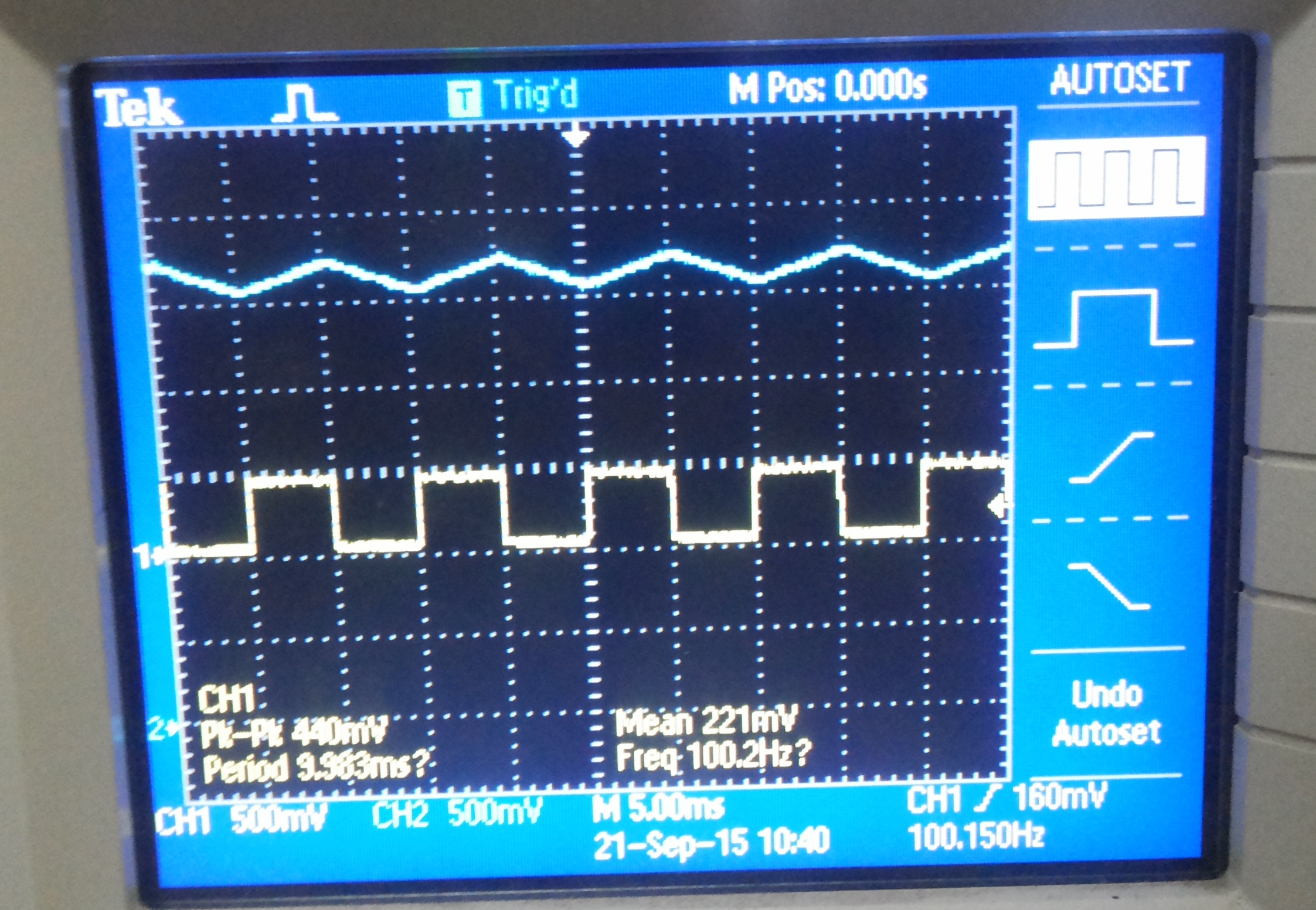

i want to measure the accurate voltage reading. The output is keep on fluctuating is there anyway to make DC or stable output
input given to irled is 100hz 10% duty cycle
Voltage received from Sensor is: 2.4497
Voltage received from Sensor is: 2.5670
Voltage received from Sensor is: 2.6696
Voltage received from Sensor is: 2.7674
Voltage received from Sensor is: 2.8065
Voltage received from Sensor is: 2.8504
Voltage received from Sensor is: 2.8016
Voltage received from Sensor is: 2.6843
The oscilloscope yellow curve shows Photodarlington output and blue curve shows the lockin amplifier output
The blue line on your 'scope is varying. Are the Arduino values accurately reflecting that variation - or is there some other problem?
If the Arduino is accurately capturing the voltage maybe you could average the value over several readings.
If the Arduino is NOT accurately capturing the voltage I reckon you need to post the schematic showing how everything is connected. A photo of a pencil drawing will be fine. A photo of your hardware is not suitable for showing wiring connections.

The yellow is the signal to the "photodarlington", its 100Hz but 50% duty cycle.

sorry i used 50% duty cycle
So for what i did is shown in page 1. i am planning to do lockin amplifier circuit is in page 2.
please correct my mistakes regarding resistor and capacitor values
any other suggestions are welcome and appreciated:

Don't forget you have a 180Deg phase shift across the opto link, a HIGH in results in a LOW out.
Also where is the current coming from to bias your photo-darlington receiver?
You are assuming that the IR darlington produces a voltage, it doesn't, it is a current device, have a good read of the spec sheet and look at the small example circuit they use for the switching time test circuit.
