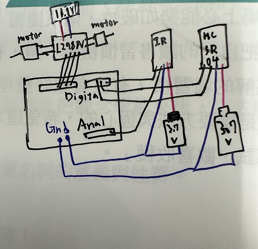

I’m doing on a L298n project but I meet some trouble. When I attach the uno with the USB port it works fine ,but it won’t work when the uno is power by 9v battery,the motor became discontinuous and sometimes disequilibrium
Always show us a good schematic of your proposed circuit.
Show us good images of your ‘actual’ wiring.
Give links to components.
Sorry I just added it
Show the power supply connections.
Show good images of the actual wiring.

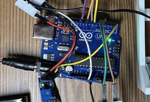

This is the actual wiring
Ps: If it’s not clear enough I can retake one
What is connected to D0 the Rx pin via the red wire?
That pin is used , along with D1, when programming and it is recommended not to use D0 and D1 in your project.
This is why you need to label your pins when drawing a schematic.
Have you measured your 9V battery when your project is running?

How have you got this jumper configured?

I think this is how your circuit is from the images.

I’m not using that jumper,it’s just a extra 5v output
And thanks for the circuit diagram
Why all the external batteries for the IR sensor and the HCSR04?
Have you measured the 5V pin to see what the voltage is with the 9v battery vs the USB connection? All you allowing for any difference with the analog reading from the IR sensor?
Cause if I don’t add external batteries the Arduino are over it’s max current
