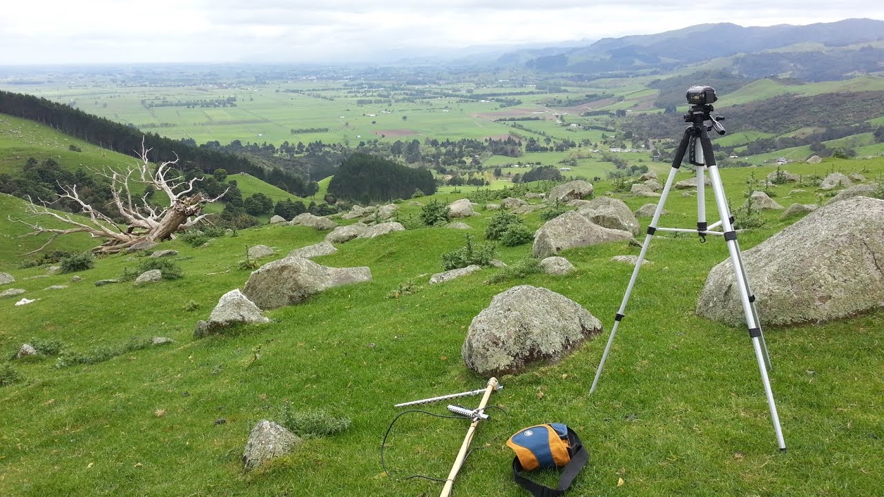

The Si4432 is capable enough though, and I think I hold the 'RC' record with the device @ 2,200km
Arguably the world record should be a bit longer... those Voyager probes are remote controlled and are pretty far out by now! But then that's maybe not a "world" record, as it's out of this world...

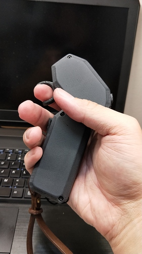

I have attached a copy of a controller from an electric skateboard which is the style and ideal size I am aiming for but will compromise where essential.
Given my preferred setup [Arduino/433Mhz TX > Arduino/433Mhz RX], and for reasons of keeping this setup as compact as possible, is there a particular Arduino board and modules that people would recommend.
