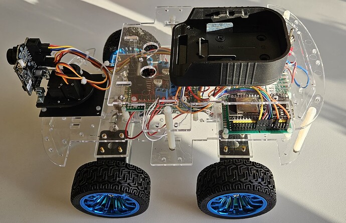

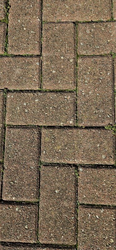

Hello,
First of all, thank you very much for the well-intentioned advice.
And OK, photos say more, so here are some.
Here one photo like many paving stones with joints that can be seen.
The vehicle should recognize the joints and drive along them as accurately as possible.
If it can do that, a laser should burn away the weeds in the joints.
(safty first of course, but this is a later task).
As mentioned, I've already tried a few things, including image recognition.
But image recognition, or better line tracking, is done with grayscale images.
Not easy with this picture.

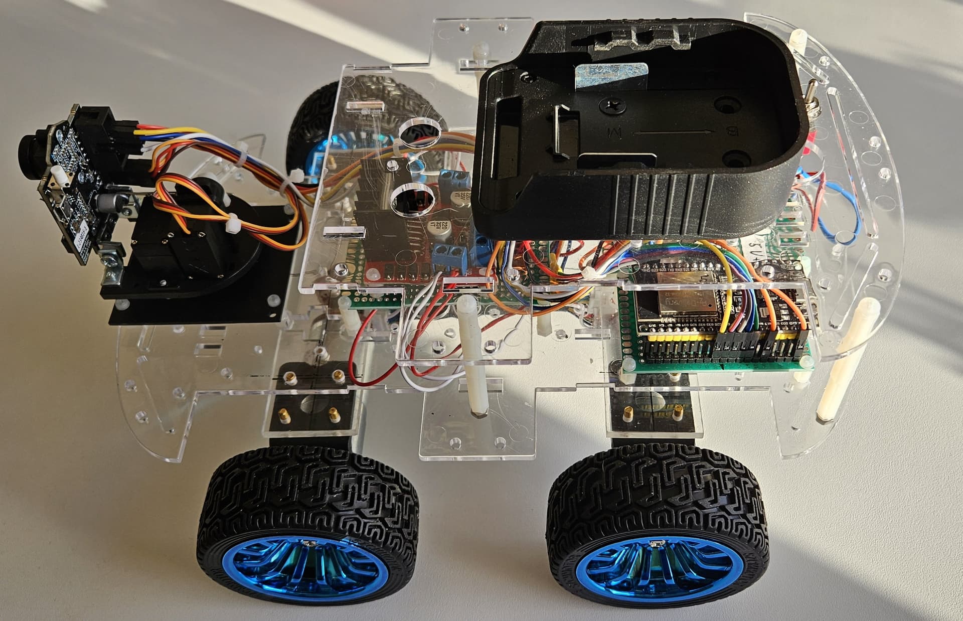

The other picture is my first attempts at image recognition.
The small vehicle is object tracking with PIXY camera, which works great by the way. It follow the object.
The larger vehicle can already track lines, even excellently if the background is light and the line is much dark as possible.
But until now it isn't so easy to recognize the joints in the stone image.
Can the PIXY be taught to recognize the blocks?
Yes, but in this case I have to change the firmware of PIXY. This would be a big task.
That can bring challenge also for the distance measurement approach.
Why "not easy"? Any image can be converted to gray scale.
Recognizing those joints would be quite simple using OpenCV. Consider using an RPi Zero or Zero 2 running linux and using Python or C/C++ and OpenCV for the line detection and steering.
There are plenty of tutorials and examples to follow, for (a randomly chosen) example python - How to detect lines in OpenCV? - Stack Overflow
Thank you for the comments and suggestions.
I have now picked out two topics that are promising.
On one hand, triangulation for distance detection.
On the other hand, which interests me very much, the use of a Raspberry Pi with a camera and its own evaluation using OpenCV.
The page "How to detect lines in OpenCV?" in StackOverflow contains really good information.
