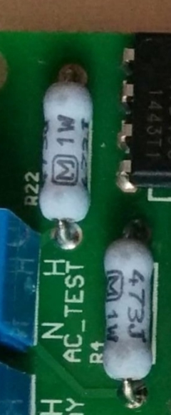

Looking for a fusible resistor 473J 47k
Good day! For several days I can not find these resistors (the picture shows the marking 473J). I found out that these are 47kOm fusible resistors, which in case of overload open and protect the circuit. It is with such characteristics that I need a resistor. Perhaps someone knows something about these resistors and their varieties and can help me with information about these resistors or find a suitable resistor in the online store of radio components lcsc (this is not advertising)? I shall be very glad to your help!
Are you sure those are fusible resistors, not normal ones?
47 kOhm is a very high value for a fusible resistor (digikey doesn't stock any higher than 15k) - they're usually much lower values...
LCSC does not carry any fusible resistors. They're an exotic part. More common to use a fuse and a resistor in series.
Maybe I'm wrong. I considered it fusible because of the fireproof case. Here it is indicated about the existence of fusible resistors 47kOm. http://www.token.com.tw/pdf/resistor/fusible-resistor-frn.pdf

See the "1W" on the resistor body? That tells you they are 1 watt resistors. Probably wire wound. The coating material is designed not to discolor when dissipating the 1 watt of heat.
Most resistors with that higher temperature ceramic case are not fusible. Unless you have other indications that those are supposed to be fusible resistors, I would assume that they're normal 1W resistors that the designers expected could get hot. It would also be really weird to have multiple expensive, exotic fusible resistors right near eachother - why would you need more than one?
DrAzzy, Mikeb1970, Paul_KD7HB thank you very much for your sympathy! Mikeb1970, if possible - ask the seller, I would be very happy! In general, I need to connect 220V (L / N) via MID400 (AC Line Monitor) to Arduino. This requires such resistors. If I do not find such ones, I'll put conventional resistors, I hope this is correct.

47k and wire-wound I think not But I agree the ceramic type coating is not unusual for higher wattage resistors
I hope you intend to use an optocoupler between an arduino input and the mains input...

Yes, MID400
