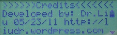

member liudr makes a nice LCD/button board
PM him to ask about purchase if you can't figure something out from his website.
