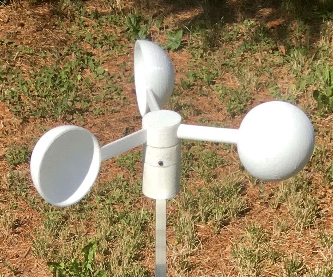

Hi.
I want to create 3d printed Anemometer, to measure a wind speed by Arduino.
That can be work if I install some sensor on the Post, and magnet on the spoon (like bicycle speed sensor), which rotate and send reading to Arduino.
I watched some examples but not sure which sensor will be good for that?
Can be good 3144 hall sensors and with any magnet?
Or, I have ready USB Fan, which have small motor, so maybe can be useful?
ANY sensor that will supply one or more pulses per revolution of the propeller will work. Even a reed switch will work. A reading does not go to the Arduino, the Arduino counts the pulses for a known amount of time and it produces the"reading".
The hard part is calibrating the home made anemometer.
Yes, that and the bearings!
I have a commercial anemometer that works with a reed switch. 10? 15yrs?
I would prefer a Hall effect switch over a reed switch if I were building an anemometer, today. No bounce to deal with and, arguably, more reliable over time.
