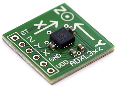

I just needed holes to connect wire leads to. How is that typically done?
-you can use a termin screw block as u can find under con-phoenix, vias is a good idea too, but i would clean up that design and place them properly like in the first picture at one spot
