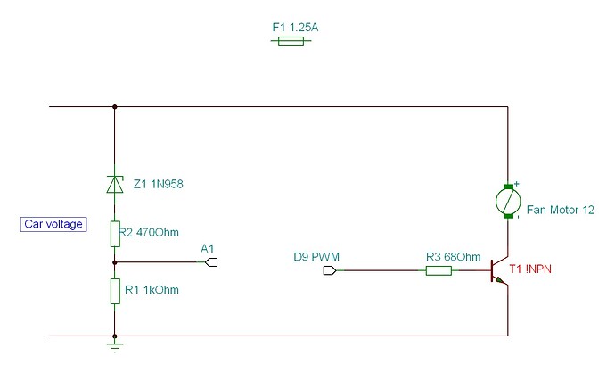

(issue 1)
I have 2 (two) NTE251 NPN Darlington Power amp transistors(Datasheet http://www.alliedelec.com/images/products/datasheets/bm/NTE_ELECTRONICS/70215952.pdf) for controlling the main cooling fan, which pulls about 16 amps continuous and no more then 30 amps and start. Will I be able to use this part to PWM the fan? what would be the best way to wire that? will i need a driver for the transistor from the AVR?
(issue 2)
I would like to be able to read signals from the 10-14 volt wiring on the truck, such as Tachometer, Vehicle Speed Sensor, Voltage output from alternator etc. What is needed in order for me to safely read these inputs on the arduino? do I need to order any special parts or can I use any fo the basic stuff I already have? (I have standard transistors and a few of these https://www.sparkfun.com/products/314 as well as a ton of standard parts)
(issue 3)
I have a few ATtiny84 and ATtiny85 chips in my inventory with (2) 16mhz crystals to change the speeds. I want to use these where i can rather then use the one ATMega328P I have on my uno board. If I do have a use for these in the design should I go about programming these without the arduino boot loader? I heard that if you forgo the boot loader you save a bit of space and speed. I don't feel that the program will be too large. I want to use my arduino uno for ISP of the ATtiny chips as they are in the prototyping stage in case I need to tweak the code or debug in my beta stage. Alpha stage will be in the lab.
(issue 4)
I want to add Audible tones for feedback into the project. either through a small speaker behind the dash or through the stereo speakers somehow. Is there a way to produce more complex sounds rather then square wave tones from the arduino? I'm thinking more like door chimes and audible warnings for temps and such. is this doable or do I have to stick with the crappy tone library?
I know this is a lot to read, I appreciate who ever looks at this. your time is valuable to me as this project is 5 years in the making and its finally coming together. I would love to be able to get all these resources together into on project and share it as open source hardware and software when the project is finally at a polished and releasable stage. something i can put together as a kit for others looking for a similar device for their project car or truck.
Issue1: The transistors should be fine. The AVR should be able to drive them directly. See schematic
Issue2: I would use a 7,5V zener diode and a voltage divider in order to bring down the cars voltage range to the 0..5V range for the arduino. The provided schematic gives you a 0 reading for 7,5V in and a 1023reading for 14,75V in.

Do you think the transistors will do fine running a high current load such as the cooling fan with PWM? the datasheet says they are for low frequency switching only. but I'm not sure if the PWM i'm dealing with is above that spec. my guess is probably not.
I might add in some safety measures to be safe such as a shunt diode and such.

The switching frequenct is no problem. Normally arduino outputs a PWM signal at about 490Hz which is quite low. What you should do (i forgot) is put a freewheeling diode over either the motor or the transistor. I suppose that is what you meant. You culd also experiment with increasing the value of the base ressitor of the transistor (increasing it).
The Arduino is sensitive to voltage spikes on the power supply and any inputs connected to it. Cars are hostile electrical environments and can cause a lot of noise due to conducted transmission of noise generated by the ignition system and other power consumers, and radiated transmission. If you're going to use an Arduino in this environment then you need to enclose in in a Faraday cage and protect every wire coming into it against voltage spikes. You will also need to protect it from contamination and mechanical vibration. It would be sensible to keep it away from temperature extremes too.

for pwm outputs this high it is best to use optocoupler, and you will have to amplify this signal with some darlington as thebase current is pretty high at 30 amps
Even with the NTE251 being a darlington with internal shunt resistors? I was wondering if I needed to add a driver of some kind, would a 3904 or 3906 BJT work to drive a little more current to the NTE251? or something much larger? keep in mind I will be using two of these NTE251's in parallel to give myself room and to ensure I have redundancy in case one fails. both should be driven on and off at almost the exact same time.
