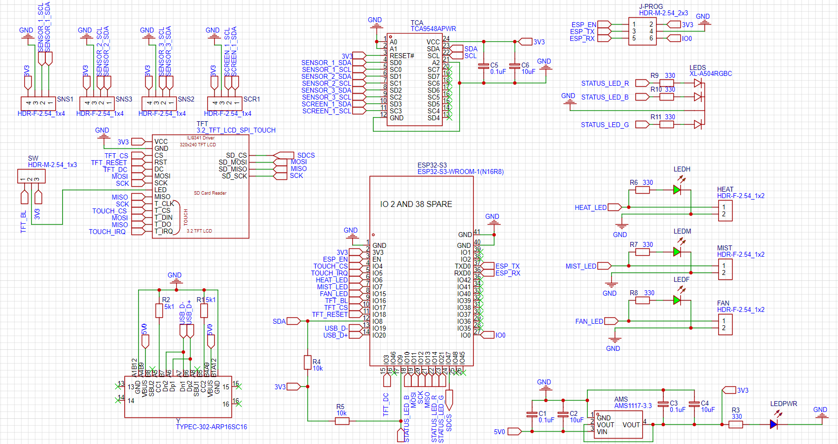

If you don't get any further then attach your schematic diagram and zip up all that code and add it also to the thread.
<div class="post-metadata">
**Author:** ![madcarbon](https://dub1.discourse-cdn.com/arduino/user_avatar/forum.arduino.cc/madcarbon/32/1197459_2.png) [@madcarbon](https://forum.arduino.cc/u/madcarbon)\
**Post date:** [May 26, 2025, 10:58am UTC](https://forum.arduino.cc/t/looking-for-pointers-esp32-s3-intermittent-crash/1384423/10 "2025-05-26T10:58:41Z")
</div>
[MK.zip](https://forum.arduino.cc/uploads/short-url/hEjHUYFow6GZ0vge2bwiuG5kSWc.zip) (7.5 KB)
 ![MK_Sheet1_SS_2025-05-26](https://europe1.discourse-cdn.com/arduino/original/4X/8/7/6/8767d40010abba7b303718e6325ac7f1480e91a6.png)
@vvb333007 numbers are always 1 - not sure if I have them in the correct place or if it is the correct implementation of how to use them.
Tried a few more things but no better - I am guessing this is down to my knowledge.

On a brief scan of the schematic the only thing I noticed is that I2C pull up resistors are not shown but if that is a TCA9548 module, these will be present.
**EDIT**
Where you have headers for HEAT, MIST and FAN is anything connected directly there which could cause a power supply glitch and/or have you noticed a relationship between the crashes and devices being switched on by your circuit ?

> [@madcarbon](#):
All 3 of them? Or just 2? Anyway 1 means your board was reset because of power on/off.
It was not a watchdog, it was not a memory corruption.. Code of 1 says "normal boot, because power went from OFF to ON"
Make a test with another power supply.

> [@6v6gt](#):
TCA9548APWR and pulls are on the SHT3x sensors and the 13066 OLED.
> [@6v6gt](#):
They will run to a second board that will control relays with these signals. Currently they are unpopulated.
The switch is also not in use at the moment.

If codes are al 1 then it is definitely something wrong with your power or EN pin. May be it is your external device that causes power go down and up
I would turn debug to Verbose (Tools-\>Core Debug Level-\>Verbose) and wait until it reboots again. There should be alot of information printed.

OK. I think I see what you are doing with the TCA9548 but it is really only useful when you have a number of devices with the same I2C address. I don't imagine that the I2C screen (SSD 1306 ?) has the same I2C address as the three sensors so it could be on the main I2C bus. However, that is not the main issue.
If you are using a raw TCA9548APWR chip (as opposed to a module which would have these) then you also need pullup resistors (say 4.7k) on the networks SDA and SCL on your schematic.

The TCA is for the 3 SHT3x modules, they can only be set to one of two addresses so over the top but they are more accurate than BME or SHT2x and not as expensive as the SHT4x is.
They have the pullups on the boards from the headers shown in the schematic. Best practise to put them as close to source as possible, as done with the main SCA SDA lines from the MCU but the board fits behind the ST9976S mounted on the back and really wanted to keep it compact and the tracing was as nightmare adding in the resistors close to the TCA.
I have ordered each part of the board modules (ESP32 socket, power, TCA etc) in that I have cut down to be modular so I can have the whole board as an exploded view once wired. Saying that I have had this working but on perfboard and one long massive .ino, that I wish I kept rather than working on splitting it out for readability.... and a little OSD 😄

> [@madcarbon](#):
> . . . as done with the main SCA SDA lines from the MCU . . .
Sorry. I missed them. R4 and R5 are correct. The SCL label has been trimmed off in the schematic so I didn't immediately see it.

Ah, sorry for that, tried to get everything in but keep the nets and labels readable.
