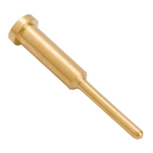

Guys, i`m looking for pins like that. they seems to be allover with ic dip sockets but cannot find them anywhere individually. Also proper name if any one know would help searching a lot as well.
If any one can point good cheap source for bulk buy than it would be very much appreciated.

Like the top 2 listed here?

Just twist off 1 or a group of pins...
Machine pin.
If you just need a few, cut a socket apart.
Yeah - those look like machined pins from pin header. They're typically embedded in a strip of plastic.

I just need to make smd to dip adaptor but I want to have option of connecting directly to if without need of taking it out. It's just modding old prom with eeprom
I simply get the heat gun out and cook a DIP Socket that has them in it, or cut them out of DIP Socket.
They are Machined Pin Dip Sockets.
Or get strip of them.

I wonder if acetone will melt it. I’m surprised that they are so hard to get.
mOskit:
I wonder if acetone will melt it. I'm surprised that they are so hard to get.
Good idea, nail polish remover.
Tom... :slight_smile:
As I mentioned, just cut them out, use eye protection.
Use nippy cutters.
