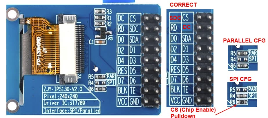

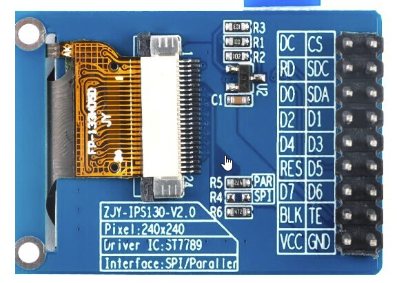

I purchased a few of these st7789 modules and have been unsuccessful getting them to work. I see that these modules may be configured for parallel mode or spi mode. The module uses the zjy-ips130-v2.0 24 pin version and I assumed the module to be configured for spi mode as default. I would like to ask if this is correct (see pull up resistor config in pic).

My interpretation would be that with R5 (labelled "PAR") populated and R4 (labelled "SPI) unpopulated, it's configured for parallel operation.
I guess I'll swap the two resistors and see if that is correct. Without a datasheet that is about all one can do. Thanks.
No luck. Moving the resistor over did not resolve the issue.

PIN No Symbol Description:
  1. DC: In parallel mode, it is the data and command control pin; in SPI mode, it is the SPI clock line
  2. CS: Chip select is active low.

So.... you are saying:
  • DC: In parallel mode, it is the data and command control pin; in SPI mode, it is the SPI clock line
  • SDC: parallel port is parallel port write, SPI communication is SPI DC pin
have an opposite definition? Go figure. I'll study the datasheet for the st7789. Confusing to say the least.

What I really need is a pin map of the ST7789 to the flex cable 24 pin out. The datasheet for the ZJY-IPS130-V2.0 would provide this.
Does this help?
Source: https://www.aliexpress.com/item/1005004616439595.html
Looks like exactly what I was looking for. Thanks.

Well after 'buzzing' the board and checking against the pin out, here is the correct way to use this module in SPI mode. The board build configuration defaults to parallel mode. The SDC and DC signals are confusing and need swapping as shown. R6 is a pull down resistor which pulls down the CS line, enabling the module if the CS signal is not used.
Also needed to use spi mode 3 (tft.init(240, 240, SPI_MODE3); ) for proper operation. Hopefully, this will help someone else with their issues.
