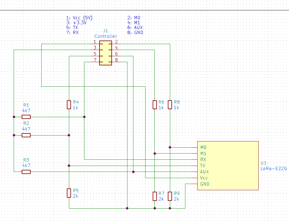

It seems you're only getting zero values so I guess there is no or a bad connection to the module. Can you post a wiring diagram and a sharp picture of your setup?
Here is the wiring diagram. However, I have checked the wiring several times without finding any errors.
Also tried to make different type of errors (broken connections, switched TX and RX) which in all cases resulted in no contact with device.
So I think the wiring is OK.
I see a big mistook if the schematic is correct. When using serial communication figure they are very stubborn and fussy. TX is very finicky and will only talk to a RX at the same baud etc. On the other hand the RX will only listen to a TX at the same baud. Reverse the two that should get you going.
Reverse by moving TX to RX and visa versa? Tried that - did not work. Got a message that there was no contact with the device.
BTW, TX on the connector (and the LoRa) is connected to the RX on the controller. RX is connected to TX on the controller.

Why do you have voltage dividers in the schematics when using an ESP32 at 3.3V and the LoRa device at the same voltage?
Are you using a different MCU?
The voltage divider on TX won't work. And why is there a pullup on RX?
I have done as described on the web page (#1). Assumed this was something that worked.
Probably not, because the web page describes different setups for 5V and 3.3V MCUs. For 5V use level shifters, for 3.3V do not.
Please answer the questions posted in #7.
Shit... damn fritzing diagrams. I see the mistake. Fixed the connections and it works now.
Thanks :slight_smile:
