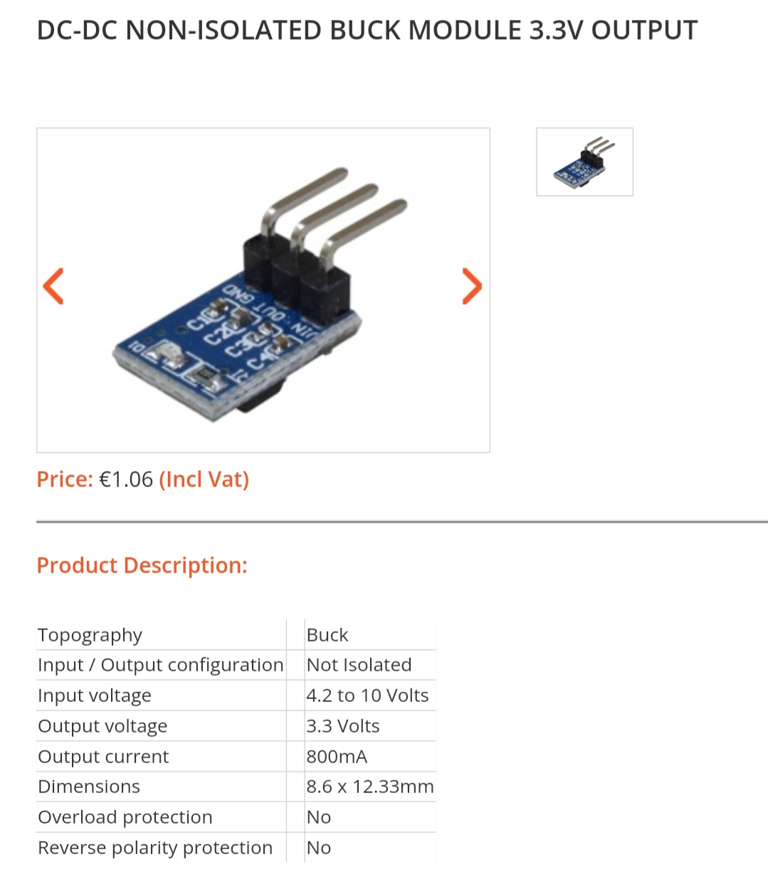

Well than, for a separate power supply could i use some thing which outputs an excess of current ( module needs 100ma max ) say 800ma (and 3.3v ) and still be fine or will i risk damaging the module
your module with "eat up" what it needs in terms of current. It's fine if you hook up something that can provide way more than needed.
Indeed You could just connect a step down converter (buck module) to the 5V pin of the Nano and "build" 3.3V to feed into the Lora module.
Okay, will do thanks! I was originally going to power the buck module with a separate power supply (battery pack) but i could just do what you recommend instead.
