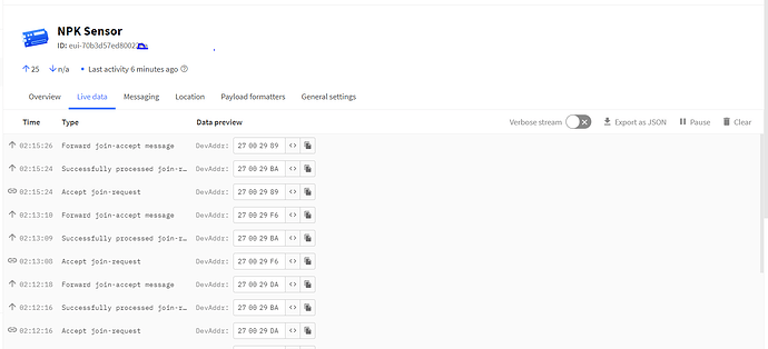

LoRaWAN NPK Sensor Data Transmission Issue
Hello! I am currently working on a LoRaWAN project using a SX1276 LoRa transceiver to transmit sensor data (nitrogen, phosphorous, potassium levels) over LoRaWAN using The Things Network (TTN). The code involves communication with a sensor through RS-485, and I have integrated LMIC for LoRaWAN connectivity.
The code seems to be encountering a problem during the LoRaWAN transmission process. I have noticed that the device successfully joins the network, but when it comes to sending the payload, I am experiencing unexpected behavior. The console shows a "forward join accept" loop, and the payload is not being sent. These are the output on the serial monitor and TTN for your reference:
I noticed that it always stops halfway on the nkKey part, so I verified the keys (APPEUI, DEVEUI, APPKEY) and they are correctly configured in the TTN console.
So I think that the device successfully joins the network, but the payload transmission seems to be problematic.

Thank you in advance for your time and assistance!
