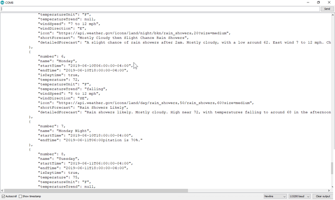

Hello, I’m trying to read JSON data from “api.weaher.gov” and display it on my e-paper module. I managed to connect to api.weather.gov and read JSON data using my Wemos d1 mini. However, when I printout on the JSON data on the serial monitor, random parts of the data are missing. When read data, it seems to read all the characters of the JSON data but when I print out completed string, there are missing parts. I tried google it but I couldn’t find anything about it… can you help me to find the problem? Thank you!!
Attached is the Serial output and below is the code.
On the Serial output, there should be more lines for number 7 but they are lost.

Never post text output as images!
Although an ESP8266 (you Wemos D1 Mini is based on it) has about 50k of available RAM (which is much more than a standard Arduino has) you must keep an eye on it's usage. You cannot code like you do on a PC with gigabytes of RAM. Reading everything into a String object (byte by byte) use a bit of memory and fragments the available memory (it's not as bad as on the AVR boards but it's not neglectable. Reserving a big buffer for the JSON document doesn't help too.
Do you get an error? If you provided the actual text output we could see what you get but on the pictures nothing relevant is visible.
@ryanjoh did you ever solve this? I have been bouncing back and forth between using wunderground or weather.gov as my sources for weather updates.... one thing that I see is a huge difference in the number of characters returned by each API...
Wunderground 5day forecast returns around 5,500 characters with spaces.
Weather.gov forecast returns well over 11,000 characters with spaces.
is there a way to hold that string of JSON data in a more efficient manner on the esp8266 before its parsed?

@pylon Thank you for your advice! I was thinking that the memory limitation could be a problem too. But I didn't have any guesses to estimate the memory limitation. And since I'm new to arduino, I couldn't narrow the possible reasons that I don't even have a clue. So now I have one supporter for the memory limitation...lol Can I ask you if there are any kind of tools or method that I can keep track of the memory usage of arduino/wemos?
And sorry for the image. I couldn't copy and paste the Serial monitor and me being lazy. Is there any quick and easy way to copy and paste the Serial monitor?
@Jmeredith Yes I’ve got over 15000 characters including spaces too. I assumed this might caused by memory limitation but I couldn’t confirm it or had a solution so I went for a dirty quick way to solve it. I took only the part that I need from the read and added to string.
