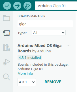

Lost linkage the definition of "SDRAM.H"
An attempt was made to remove unused libraries via the "Library Manager" and it appears that I removed too many. Now the #include <SDRAM.h> yields an compile error: fatal error:
SDRAM.h: No such file or directory
I'm a Newbe and cant figure what library to re-include with the "libraryManager" to resolve this. My Hardware is a Arduino GIGA R1 Wifi

Hi @lapowels!
Did you try to (re-)install the Giga board files using the board manager:
That might help ...

did not help. I removed "Arduino Mbed Giga Boards and re-loaded it.
The Verbose compiler option yielded: (This error occurred after I started working with a second processor card "halloWing")

C:\Users\lapow\OneDrive\Documents\Arduino\DatabaseServer\DatabaseServer.ino:1:10: fatal error: SDRAM.h: No such file or directory
1 | #include <SDRAM.h>
compilation terminated.
Alternatives for SDRAM.h: []
ResolveLibrary(SDRAM.h)
-> candidates: []
exit status 1
Compilation error: SDRAM.h: No such file or directory
After a second look at the Compiler Verbose Output. I see the board "HalloWing" was selected. I changed it to "Arduino GIGA R1" and now the sketch compiles.
This issue is now resolved. Thanks ya all.
