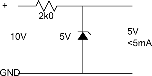

Perhaps the easier way of limiting current is to simply make it impossible to draw too much. If you need 5V at 2.5 mA, but you can accept up to 5 mA, simply design a power supply with those characteristics. For example, a 10 V power supply with a 2 kOhm resistor will generate no more than 5 mA of current. Put that across a 5 V Zener diode, and you know that the output will never be more than 5V (at the cost of some idle power consumption.)
And that folks is what one calls a "zener barrier". Slightly more simple than those used to provide "intrinsic safe circuits" which limit both current and voltage into areas of explosive atmospheres. The simpler commercial ones generally use two resistors, two zeners and a fuse.
Yes but that only limits the current to a zero impedance load. The problem is that it will also starve current from a real load.
