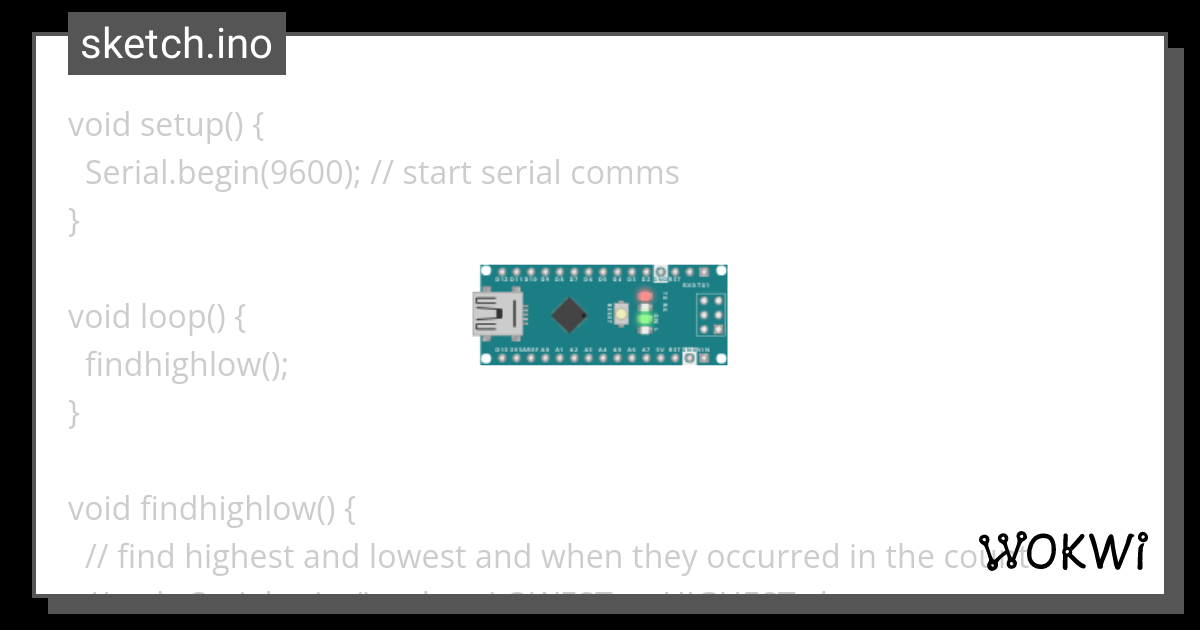

  Serial.begin(9600); // start serial comms
  findhighlow();
void findhighlow() {
  // find highest and lowest and when they occurred in the count
  // only Serial.print()s when LOWEST or HIGHEST changes
  unsigned long reading = 0; // new reading
  unsigned long highest = 0; // highest value (set to lowest possible value)
  unsigned long lowest  = 1023;// lowest value (set highest possible value)
  unsigned long count = 0; // running count for when min/max occurrs
  unsigned long readCountHighest = 0; // the reading count when the highest value occurred
  unsigned long readCountLowest = 0; // the reading count when the lowest value occurred
  boolean newCurrentHighLow = 0; // signals a new high or low
  // randomSeed(analogRead(A0));
  while (1) {
    reading = analogRead(A0); // random reading
    count++; // store loop count
    if (reading > highest)
      highest = reading;
      newCurrentHighLow = true;
      readCountHighest = count;
    if (reading < lowest)
      lowest = reading;
      readCountLowest = count;
    if (newCurrentHighLow) // only print when a new low or high ocurrs
      newCurrentHighLow = false;
      Serial.print("(NEW value ");
      Serial.print(reading);
      Serial.print(" at count ");
      Serial.print(count);
      Serial.print(")");
      Serial.print(" (LOWEST value ");
      Serial.print(lowest);
      Serial.print(readCountLowest);
      Serial.print(")");
      Serial.print(" (HIGHEST value ");
      Serial.print(highest);
      Serial.print(readCountHighest);
      Serial.println(")");
