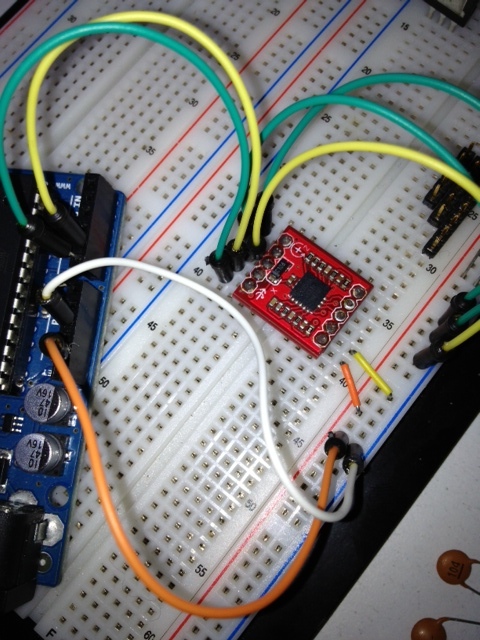

Remove all the wires.
Connect the 3.3V, the GND, and the analog outputs (not the X4) to the Arduino.
Can you make a photo of that, so we can check it ?
Do you have a multimeter to read the output voltages ?
well i did not send 5 volt but i do not know if someone had.Also datasheet says that it can get 6V so it should work.Anyway i go the results:
Pitch Voltage is : 1.25976562
Azimuth Voltage is : 1.25976562
I looked in the datasheet again, and you are right.
The maximum working voltage is 3.6, but the chip absolute maximum is 6V.
The connections and values look good to me.
Can you twist and rotate the breakboard, to see if the values change ?
If they do, you can connect to the X4 outputs.
You might try the test mode, but if it is working, there is no need to.
If something is still wrong, please upload your complete sketch.

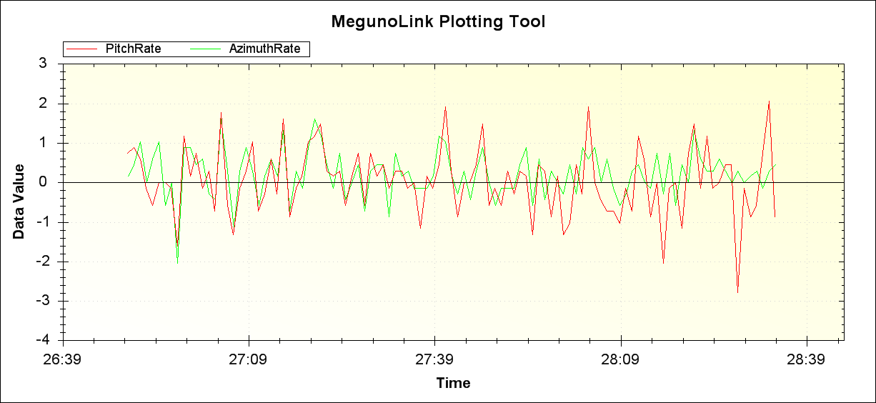

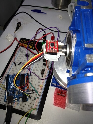

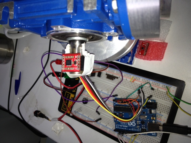

well i will give you also a plot and a photo.According to how the motor you will see is moving the pitch should have possitive rate/sec. This motor does 1 turn /7min so it is 420/360 = 1.xxxx degrees /sec
i did not see at the datasheet if it says that according to the equation at page 9 the angle is at rads or degrees, i supposed it is at degrees.
i forgot the plot
gyroWithMotor.ino (5.98 KB)

Is that motor with a gear ? I think you are measuring the grinding of the teeth of the gear.
You might have to do extra filtering in the code.
Sorry first of all i know that the way i set steadystate variables is not correct and i did not want to take the average, i think i have to do something else.
These are 2 dc motors.The ear box is big. I have a working accelerometer , and i want to take the gyro also in order to be able to calculate the angles(yaw and pitch).
The diagram gives negative and positive results when the motor moves to one way.And as i said it should be only positive. I am afraid that the gyro can not detect movement of 1 rad or degrees per second. Also what is the unit that measures angles at the page 9 of the datasheet? isn't it degrees?

i have an accelerometer. But can you tell me that is this the correct result i should get from the gyro? shouldn't be a steady (almost steady ) line only in negative or positive values?
Well, can you rule out the grinding of the teeth of the gear.
For example, taking the sensor in your hand and make smooth motions.
