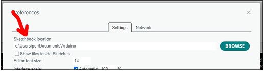

To override the default lv_conf.h to add extra functionalities, the best method currently is:
  • create a folder in $sketchbook/libraries (calling it, for example, lvgl_qrcode), inside this library create an empty lv_conf_qrcode.h and a valid lv_conf.h (copy the content of lv_conf_8.h and change LV_USE_QRCODE to 1)
  • In your sketch, before any other include, include lv_conf_qrcode.h
This will make the lvgl header discovery pick your modified config file instead than the default one.
This is the same method used by this tutorial (an example of the overwriting library is in the downloadable section)
When you specified $sketchbook what does that resolve to? Is that the starting path for the project main ino file?
Assuming the above I created the folder structure (C:\Users\OBFUSCATED\Documents\Arduino\agsmac\libraries\lvgl_qrcode) and did as you indicated with files but there was no lv_conf_8.h but there was an lv_conf_template.h so I used that instead. Also as instructed I put in #include "lv_conf_qrcode.h" before all the other includes.
Unfortunately, the compiler immediately returned with the following:
compilation terminated.
exit status 1
Compilation error: lv_conf_qrcode.h: No such file or directory```
It is the path you will see in the "Sketchbook location" field in the Arduino IDE preferences (File > Preferences).

I don't know if this helps or not but I was able to confirm that the lv_conf.h file is getting picked up. I verified by inserting a #pragma message(...) in the first line and it showed up during the compile.
I see the problem here in your lv_conf.h:
Change that line to this:
#if 1 /*Set it to "1" to enable content*/
after that, try uploading the sketch to your GIGA R1 WiFi board again. Hopefully this time everything will work as expected.
Finally! Compiled.
