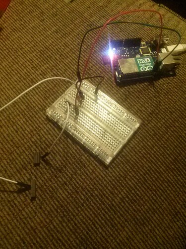

I'm still new with the arduino Microcontrollers and have no previous experience in electronics other than IT (and coding)
I want to make a door/window alarm using a magnetic "switch" when the magnets are forced apart ide expect the conneciton to break.
I tested this out with some fridge magnets and 2 lead wires but i get no current through the magnets (of course)
I'de like to know if there's an alternative to magnets or if i'm just doing something wrong? I need some sort of direction; I know what I want to do I just need to learn where i should go to learn it.
e.g..
(leadwire)-----[magnet1]|space| [magnet2]-----(leadwire) =this is a broken circuit=
(leadwire)-----[magnet1][magnet2]-----(leadwire) =this is a completed circuit=
I beleive i'll need a hall effect sensor and a magnetic field sensor to detect this?

How would someone complete a circuit with wires that have magnets on the ends of them? lol.
Are there any alternatives to this method?
With all due respect. If you are talking about the standard door /window sensor pairs in the white plastic cases. One of them has leads (the reed switch ) and the other doesn't (magnet). The circuit is completed when the reed switch is in the magnetic field of the magnet. I don't know of any magnets with wires. I know of hall -effect sensors that would have wires and work the same way as the reed switch but the magnet wouldn't have any wires so we are still not on the same page. Post a photo of what you are talking about and a vendor link.
raschemmel:
no vendor link, i just did this myself, heh. I'm literally just trying to use magnets for a connection. It seemed like a good idea. lol.
http://forum.arduino.cc/index.php?action=dlattach;topic=238011.0;attach=80196;image
A reed switch looks like its exactly what i'm looking for actually. I didn;t know they existed. thanks!
