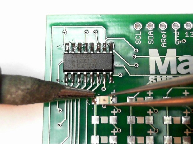

Since there seem to be no published schematics and no working examples we will have to determine the schematic by experiment. If you run the following code, exactly what pattern do you get?
In theory it should light each LED for 1/10th of a second in a regular pattern. By knowing the pattern you get we can determine what shift-register pins are connected to the various rows and columns

Zero LED's lit up. I will manually test the Clock and Data pins. BTW: found the datasheet on the Two 595 http://www.nxp.com/documents/data_sheet/74HC_HCT595.pdf
OK, so that probably means that the Data and Clock pins were right before. :frowning:
How about changing “MSBFIRST” to “LSBFIRST” to see what that does to the pattern?
I can’t think of a reason why only the last row lights up one at a time while the first seven rows light up all at once.
johnwasser:
I manually tested every pin and LED. To my surprise every single LED was inverted (cathode,anode). Looking back at the instructions I found the culprit. The assembly instructions are wrong, they invert the cathode. Funny thing is that the packaging image shows the correct placement of the LED’s, but the instructions completely show the opposite. I have contacted Make Magazine. Thanks again so much for your help. Once I get a new Shield I will let know which code actually worked. My goal is to build a 80’s boom box inspired Audio Spectrum Analyzer.
With a symmetric 8x8 matrix driven directly from the shift registers it shouldn't matter which way around the LEDs are mounted as long as they are all the same. :(
I wonder how they get the horizontal traces and vertical traces to pass each other without connecting. What does the circuit board look like under those LEDs? It's strange that your trace don't look the same as the ones in the MAKE article: http://makezine.com/projects/joey-1-smd-arduino-shield-kit/
I tested the traces (as much as I could) and they all seem to be connected where they shouldn’t, The last Column is the only one I was able to manual light the LEDs one by one. When I apply a little voltage to any LED, the entire Column lights. (except the last Column)
Also I have a few spare SMD LEDs left from this project, I tested them and I can confirm the Green Line is the Cathode.
Wow you are totally right the positive end trace is not even visible on this image.
