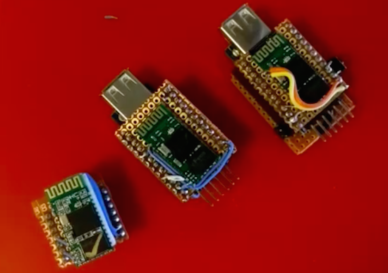

I´ve found this tutorial on internet and was more or less what I intended
Basically I would use a laptop with a BT dongle, then the HC-05+PL2303 USB to Serial converter wired like the tutorial, then connect the USB (I shall modify it for type B usb) to the smartpack
Is this ok? or do I need something else?

Maybe I'm missing your intention, but as I understand it, you wish to feed data from black box to laptop via bluetooth with Arduino as an intermediary.
BlackBox USB port > cable > Arduino USB host shield> Arduino > HC-05 > wireless > PC.
The above assumes laptop has bluetooth built-in. If not add $4 bluetooth dongle to vacant USB port thereon. The BlackBox>Arduino cable would be the one you currently use.
Frankly I would be surprised if you can't find a bluetooth USB A dongle that goes straight into BlackBox, thereby absolving you of all this Arduino stuff.
I believe the PL2303 is serial device that enables you to programme an Arduino that has no on-board UART, like a Pro Mini. I believe you can also use it to configure HC-05, but this is an Arduino forum so I don't know why you would want to do that, and there is nothing to suggest you need to configure HC-05 anyway. Don't buy it until you are sure you need it, which is probably not now.
