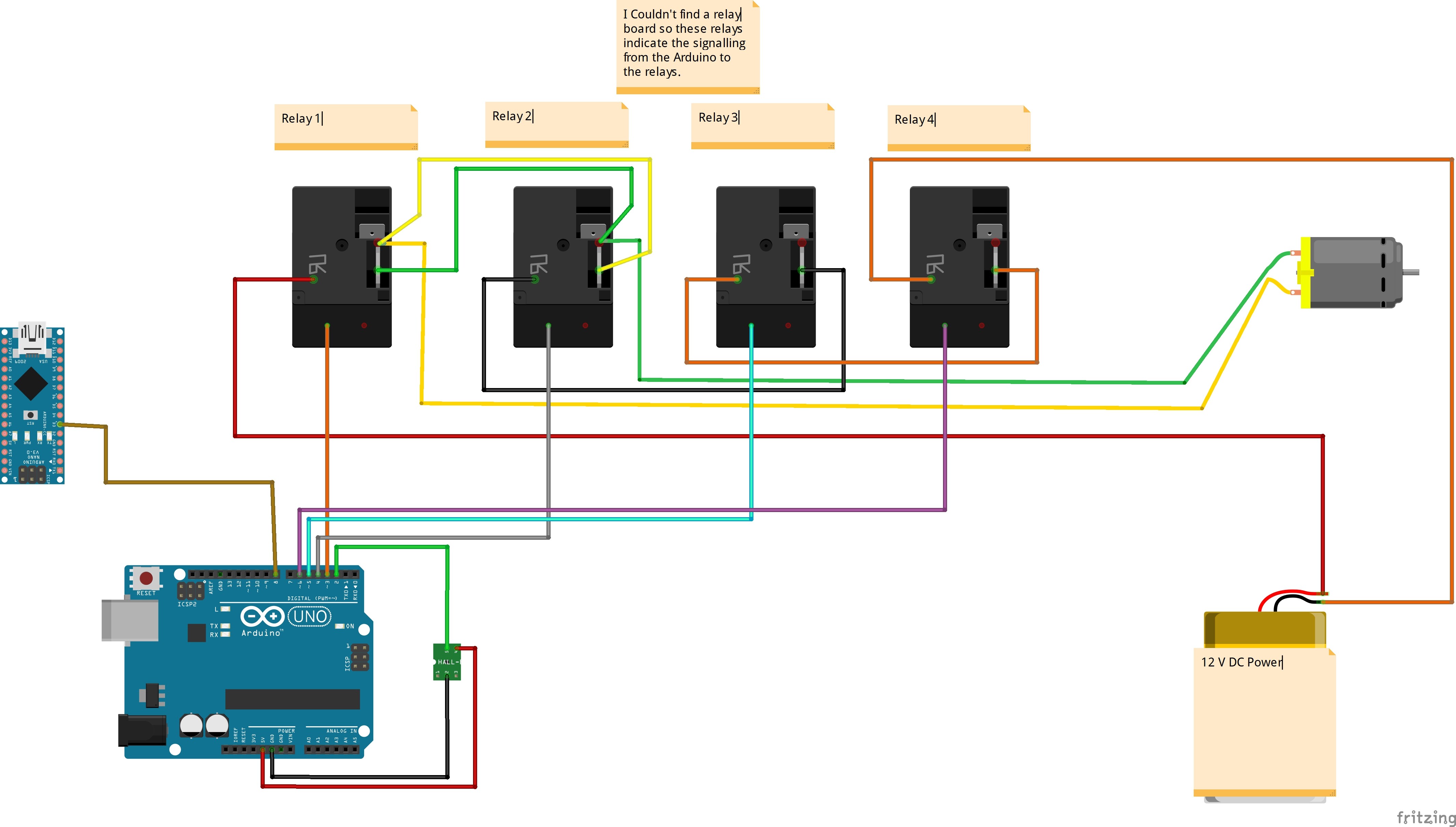

It would be best to draw a schematic and show us.
This is a schematic of the system. I couldn't find a 4 relay board so I have added 4 relays with the line from each Arduino port to each relay.
The rest should make sense I hope.

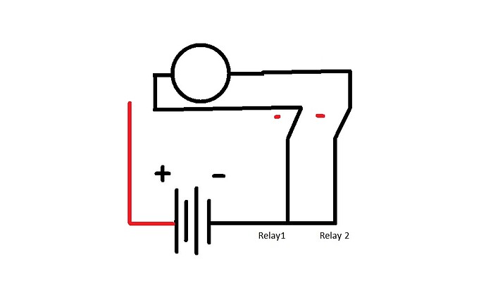

Hi
I am still totally stumped as to how you can change the polarity with two SPDT relays.
If both commons at NC are at GND and then you take one to HIGH I can't see how that gets me to what I need re the positive terminal.
I have attached a rough schematic (I am new at Fritzing) so have stuck with Paint at this stage.
Could you please add in the bits I am missing.
I really am not sure how it will work.
Thanks
This is what I have in mind
...R
In the SPDT relay diagram in Reply #9 it is assumed that both relays are triggered by the same signal. That is not necessary and if they are triggered separately there is no need for the ON/OFF relay.

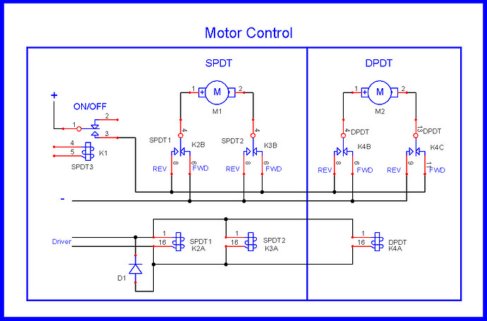

Just a representative drawing with SPDT vs DPDT.
Wiring can be modified as needed.
OP did say "Relay 3 supplies the power to Relays 1 and 2"
(in this schematic, K1 supplies power to K2 and K3)

My sch was a left over from other training.
Yes, when you are using SPST relays there is no need to use a relay for on/off
