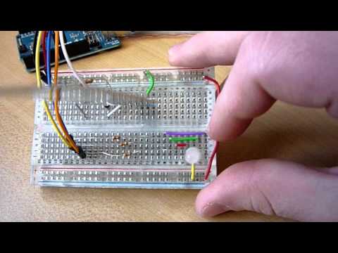

You want all 8 lights to vary in brightness? But all 8 have the same brightness at a given moment?
I don't think you can control the brightness of an LED with a 595 shift register. With the 595, the LED will either be ON or OFF. There is no in-between.
Certainly, but you could pulse them. Assuming for the moment that you want them all the same brightness, you could send out the required pattern, wait a few milliseconds, and then send out "all off" and wait a few more milliseconds. That way you get a dimming effect.
EXACTLY! And I want the brightness level to correspond to mapped analog input data.
For example: using an accelerometer, map tilt data to a 1x8 array of LEDs so that the "brightness" corresponds with the tilt angle.
In the example above, I want to use a 595 in place of a single LED so that the effect can be on a larger scale (instead of one LED, shifting the effect to 8 LEDs making the total 64 controlled LEDs and potentially more depending on how many are registers are daisy chained).
Can this be done?
This project is similar to what I want to achieve but it doesn't use a shift register.
Instead I want to use the analog input from an accelerometer and map it to control brightness of several LEDs via a 595, so all LEDs will brighten or dim dependent on the angle of tilt.
I think I would do this instead, if I understand the requirement:
Map the analog brightness to a PWM pin, use that to drive a transistor to control the LEDs.

This shows the software way:
#include <SPI.h>
const byte LATCH = 10;
void setup ()
  SPI.begin ();
}  // end of setup
const byte maxDimIterations = 30;
byte c;
void loop ()
  c++;
  for (byte bright = 0; bright < maxDimIterations; bright++)
    digitalWrite (LATCH, LOW);
    SPI.transfer (c);    // wanted bit pattern
    digitalWrite (LATCH, HIGH);
    delay (bright);
    SPI.transfer (0);   // all LEDs off
    delay (maxDimIterations - bright);
}  // end of loop
What this is doing is sending out the pattern we want to see (c in this case) and then alternating that with sending 0. So we see desired pattern some of the time, and nothing the rest of the time. This makes them seem to brighten.

Well if you want them all to show the same thing, a 595 is hardly necessary. The whole point of the shift register is you can have (say) 8 LEDs and have them all showing different things from time to time. However in case this is what you want, I tested the idea of the MOSFET:
I made it up and it actually works. I haven't shown every LED, but you get the picture. The "ground" side of all the LEDs goes through the transistor, and the transistor is connected to a PWM output, so you can vary the brightness of all of them. This sketch demonstrates:

But as I say, if you just want 8 LEDs always on, skip the 595 part, and just use the transistor. (The output pin won't be powerful enough to drive dozens of LEDs).

So how many correctly wired 20mA LEDs could a transistor reliably power on 5V?
Well, 30 amps is 30000 milliamps. So you are asking how many times 20 goes into 30000?
AND what is this heat sink business? How does that work exactly?
The transistor in question has a big hole at the back. The idea is to bolt on a bit of metal called a heat sink to help conduct away the heat.
