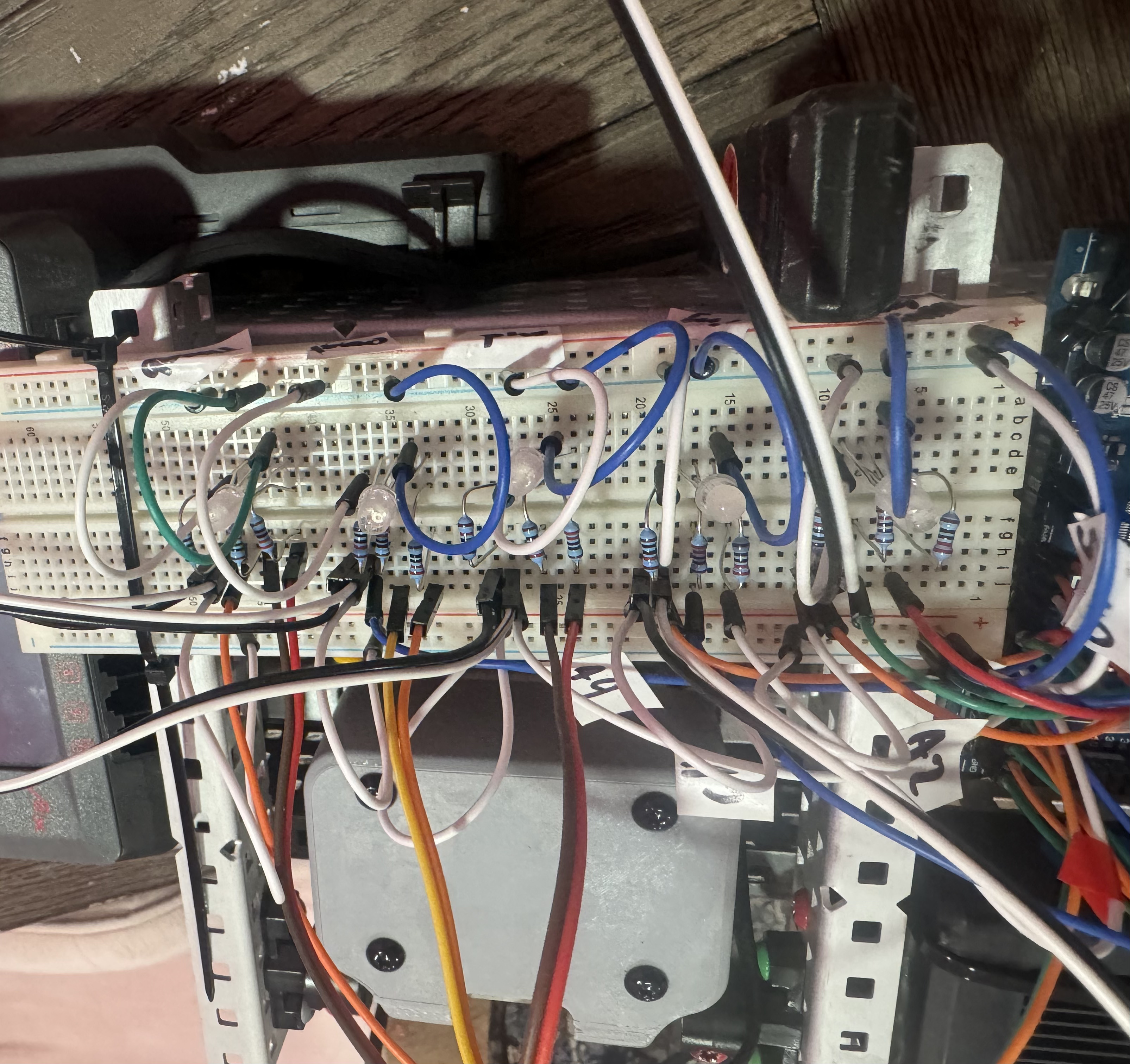

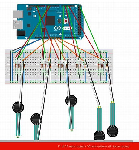

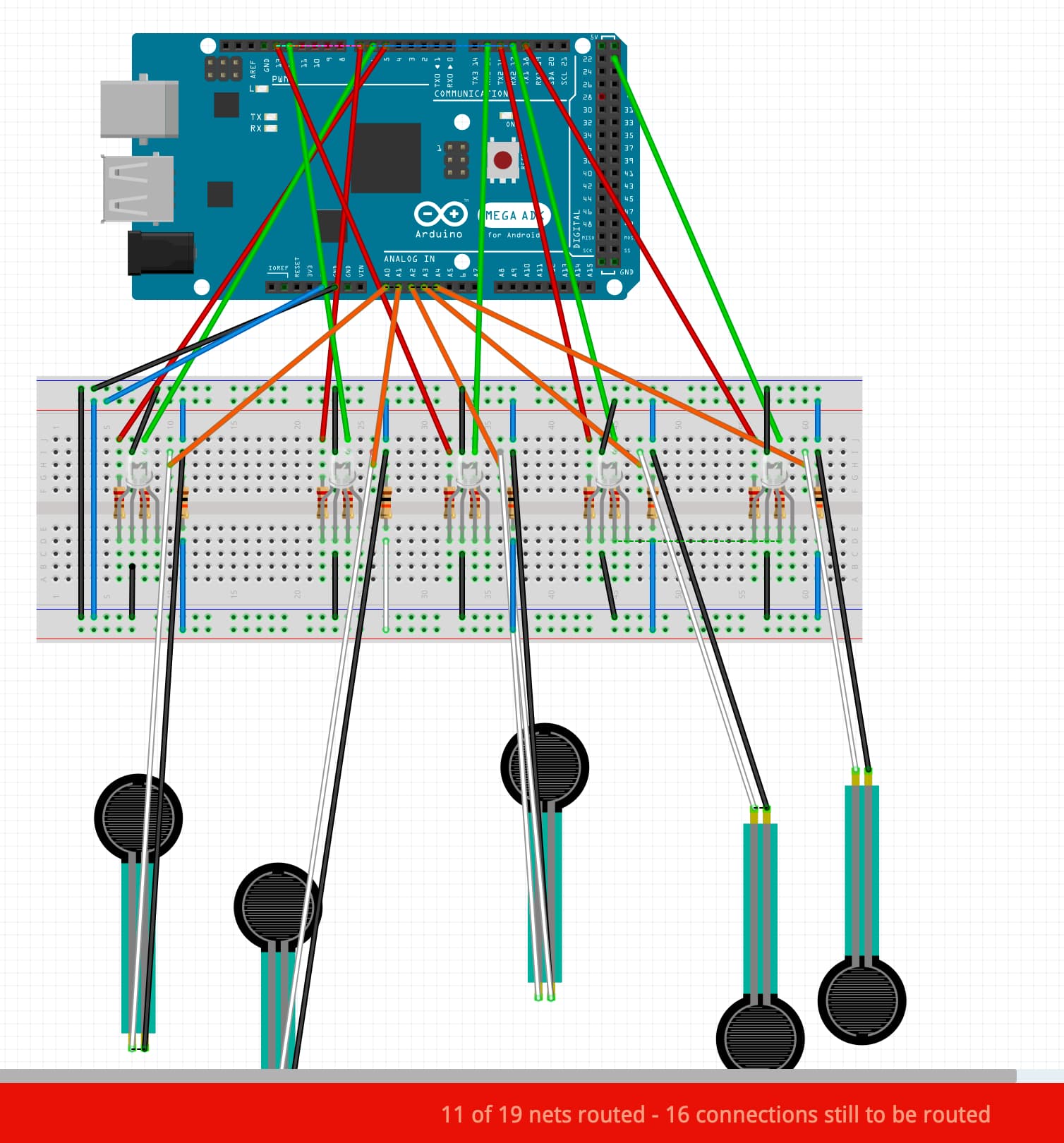

Hello! I am new to Arduino! I have a project due tomorrow (oops) and it consists of mapping 5 RGB leds to 5 force pressure sensors. (my goal is for them to change colors depending on how much pressure is exerted). So far, the first one lights up based on the pressure however the other ones do not change colors according to how much I pressure the sensors.

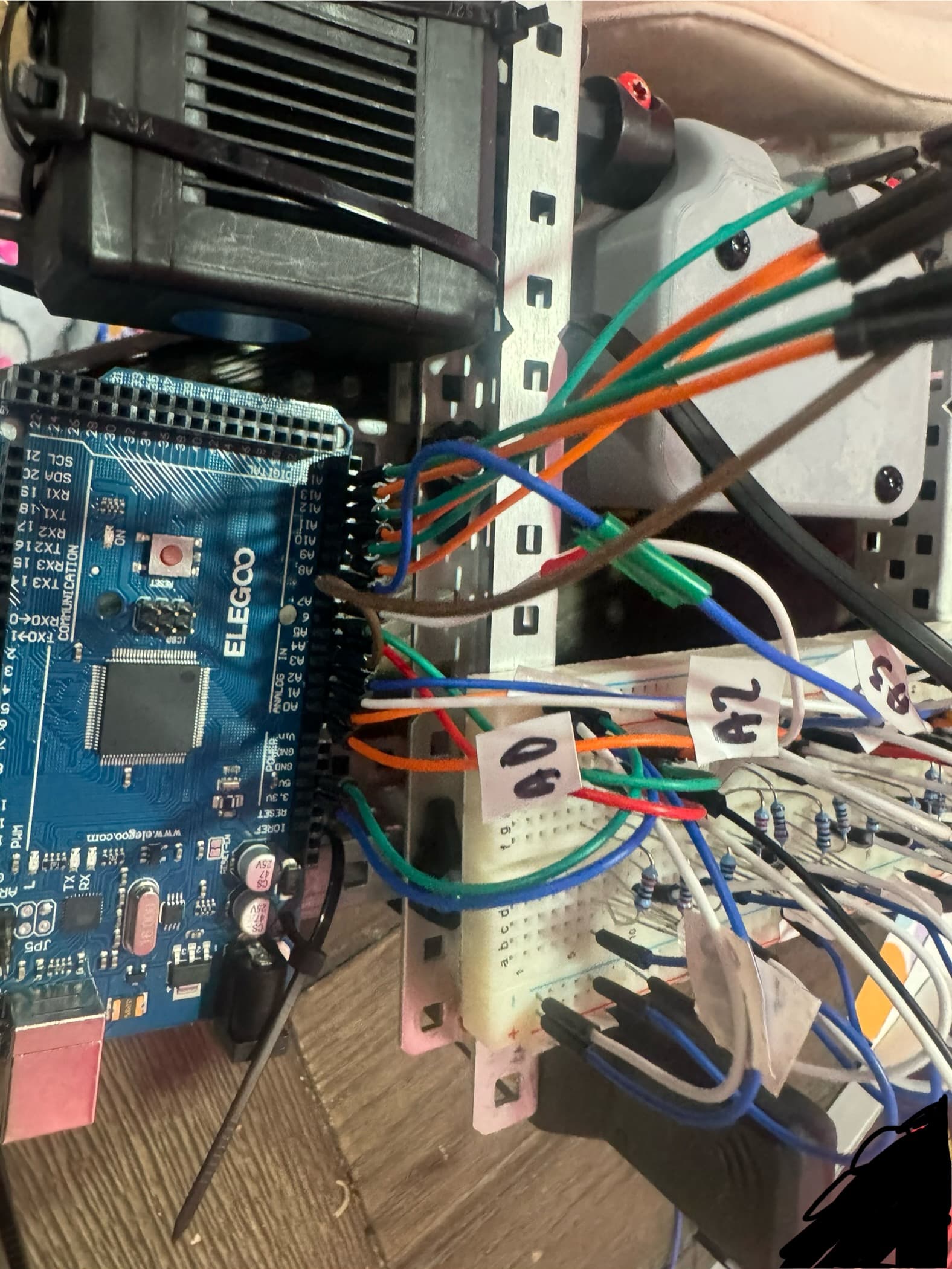

Here is a picture of what I have. There are a lot of wires so feel free to ask questions. The resistors for the RGB lights are 200 ohms, the resistors for the pressure sensor is 10kOhms
FYI: the black and white writes are for the pressure sensors. white = analog and black = 5v. Plus, - is ground and + is 5V
I do not think this is a programming issue, but here is my code:

Verify your LED pins are PWM (right column)
https://docs.arduino.cc/retired/hacking/hardware/PinMapping2560/
I put the LEDs in analog. I did not use the digital ones. Is this why since it doesn't say analog is PWM?
Sorry, most of your pins are good. You need to move pin 1. That pin is reserved for Hardware Serial.
When this starts, all the greens are ON. when I change the value of the input pins, nothing else seems to change. What is supposed to happen when each force increases?
Hey! Your originally suggestion worked for me however, the lights aren't turning dark enough (with the red)
Also, when each force increases, the light will start to go from yellow to red, like a gradient
Is that what you want?
I made some pin changes here, in Pin 1, but is this what you mean?
