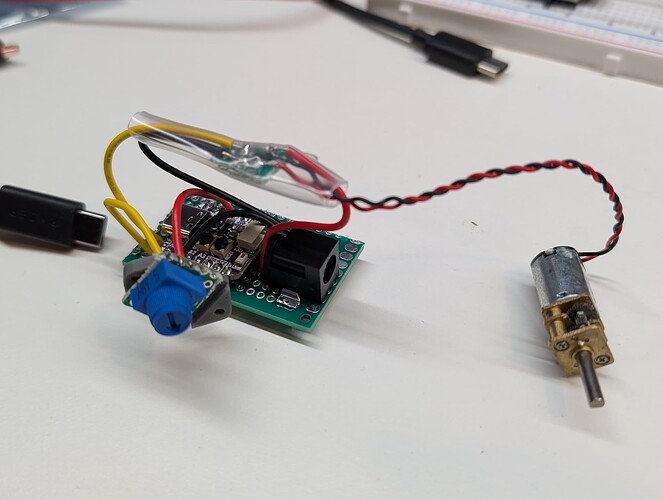

Electronics
First I have a hand-soldered motor driver.
The driver's schematic is like this:
The DC motor is a little dinky thing with a stall current of 60mA at 5V, so a BJT like the S8050 can work for driving it. I've since ordered some MOSFETs that I would use if I were building another one. I learned to solder SMD components to perfboard on this YouTube channel, which is well worth a watch.
I used a similar approach to put together the controller board:
The board simply connects the ESP to the motor and a potentiometer. The potentiometer is there to allow increasing power for taller marble runs -- the auger is stackable and thus can be made to fit and lift more marbles with more middle pieces.
