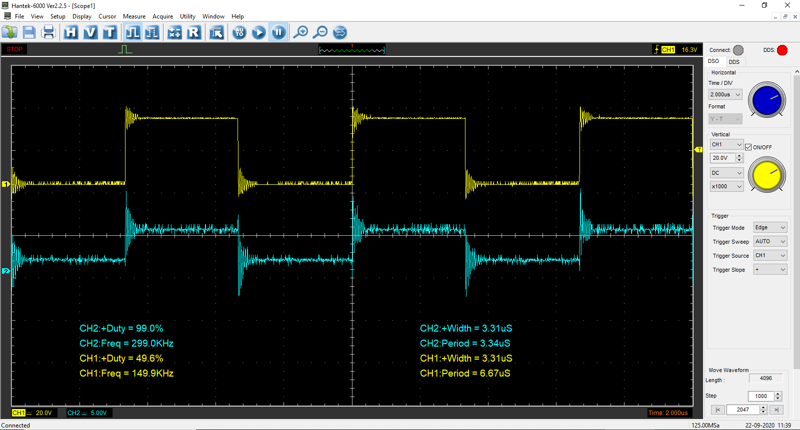

Just for now I would be happy just getting 2 PWM signals where one is like 50% duty cycle and the other is 45% duty cycle and the 2nd one is inverted and about 5% dead time between them. Something like in the attached picture. I can pretty much use any of the pins on the XIAO microcontroller but cant figure out how to get this working. I got this working on the Arduino Mega2560 but its a different chip essentially I did it with a lot of while loops and manipulating the OCR1A and OCR1B registers. I was hoping there is a better/cleaner way.
When I run the below code I get the attached image on the scope (current code scope results.png)

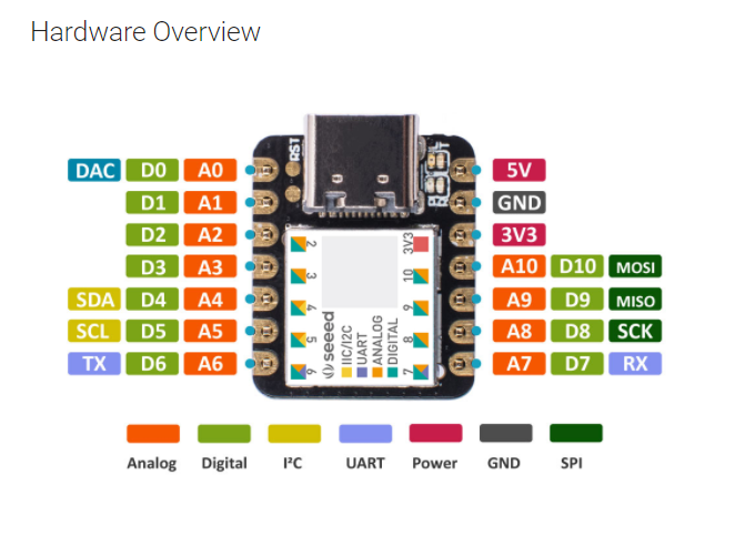

  Currently trying to use pins D2 and D3 which according to the schematic is PA10 and PA11.
  XIAO D2 is PA10 (even port so PMUXE)
  XIAO D3 is PA11 (odd port so  PMUXO)

The SAMD21 datasheet isn't very clear when it comes to explaining how to generate complementary PWM signals with dead-time insertion.
Essentially, generating dead-time insertion requires the TCC0 to be configured for a given channel output and its complement.
The channel outputs and their complements are as follows:
Channel CC0: output WO[0] and its complement WO[4]
Channel CC1: output WO[1] and its complement WO[5]
Channel CC2: output WO[2] and its complement WO[6]
Channel CC3: output WO[3] and its complement WO[7]
Unfortunately however, in order to provide analog inputs on every pin, Seeed Studio have sacrificed the XIAO's ability to perform dead-time insertion, as the TCC0's complementary outputs (WO[4] through to WO[7]) haven't been broken out.
Hi zebrawolf,
A workaround is to use dual slope PWM on both channels 2 (PA10) and 3 (PA11), but reverse the polarity on channel 2 and set their duty-cycles appropriately:
