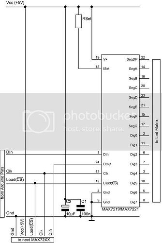

I have made up a 7x8 LED matrix being powered by a MAX7219, but am getting 8 blank spots, have checked the wiring for shots, and even tested the LEDs individually and they work fine?
Any thoughts on what it could be?

Can you give some more information on how you have wired it up and your code please?
Yes, sorry i really should have done that in the first post!
this is how i have the MAX hooked up (works 100% with seven segment LEDs)
then the matrix is like this (- the DIG 7 row as its a 7x8 matrix.....ran out of proto board)
The code is the sample sketch for a 8x8 matrix

I would write a simple test sketch where each led is turned on and off one after the other, so you at least know the software is working.
See code at end ....
If only a few leds miss to to light up or weird combinations light up they usally are wired in reverse (anode/catode wrong way round).
Eberhard
