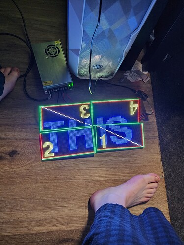

Got this code on github, from majsatic, however will not work all the way for me am I missing something

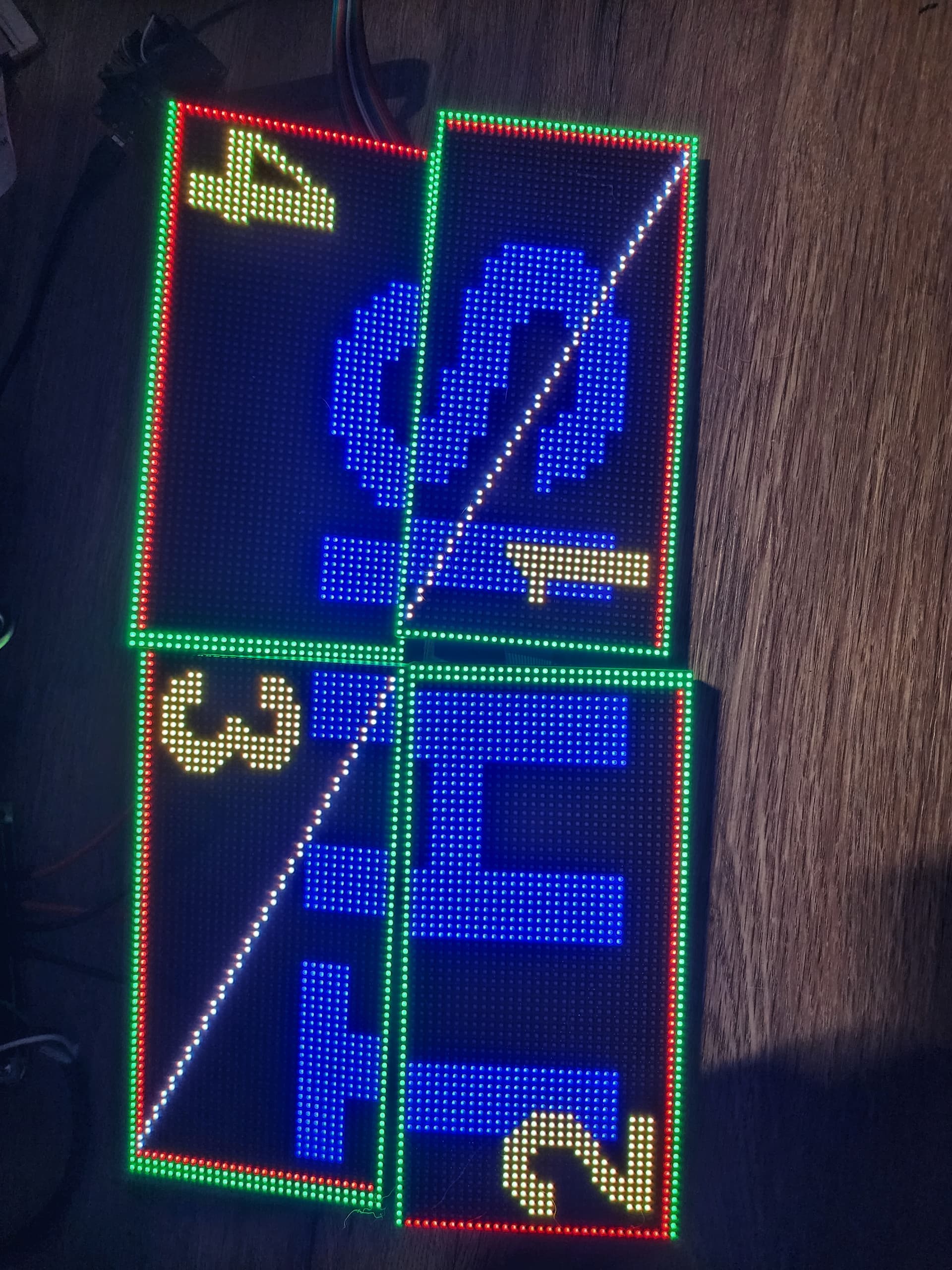

since I am still way to new to figure out the problems if i can get pointed to the right area that would be helpfull.
 ![20250906_192302](https://europe1.discourse-cdn.com/arduino/original/4X/a/2/3/a23801cc9042116e6d4915f609e161bf7d864600.jpeg)
 ![20250906_192307](https://europe1.discourse-cdn.com/arduino/original/4X/d/0/8/d0819ddc56d20066209243b29d98fac9d0fe4d06.jpeg)
as can be seen the grid works fine except that grids 2-4 are off one pixel no matter if I switch the panels around.

Please, remove the code tags from around your final comment for easier reading.
Would you hand-draw what you you expect (where the color lines/rects go) versus what you see on each panel? "Off one pixel" can be anything,
Observing/guessing here; resizing your panels with -1 or -2 might not change the origin (0,0), that is to say, the re-sized height and width might have the same starting point... and "-1" will create an odd number of rows/columns... you might need to resize in even numbers, -2, -4, et c.

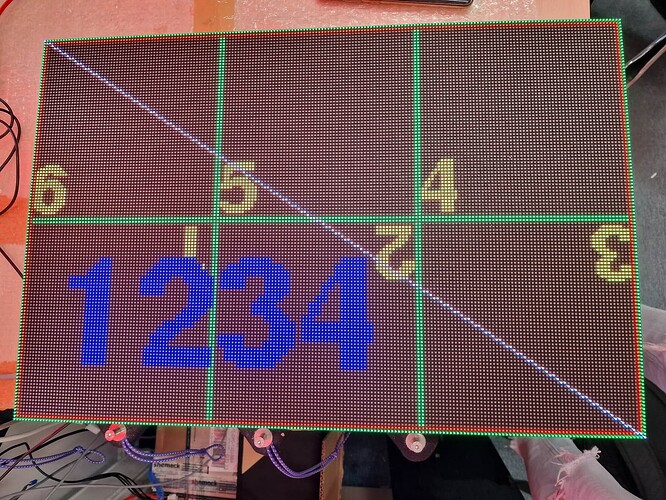

supposed to be green box outline, red box covering all 4
 ![image](https://europe1.discourse-cdn.com/arduino/original/4X/1/4/0/14015f5edfd5b104672108b83bae31295aac497c.jpeg)
like picture above but for 4 panels just cant get help from original site

The original in Post #3 shows the "feet" of 1 and 2 touching the "feet" of "6 and 5" (4 and 3 for you). You have the "head" of 2 and 1 touching the "head" of 3 and 4.

with the panels looking correct. just gonna make it like a message board at certain points.
 ![20250908_104402](https://europe1.discourse-cdn.com/arduino/original/4X/e/9/f/e9f715c7d9fda6033e1ffdb9766585e008edcc99.jpeg)
