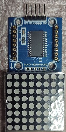

Hi, I have in my project an esp8266, three Max7219 8x32 dot matrix displays, a DS18B20 sensor, DS1307 RTC. I divided the clock board into 5 zones for display.
I have a problem with displaying values. For a while everything is fine, but then the image may flicker, and then whole squares begin to glow. Look at the attached image.
What is the problem and how to fix it?
Sounds like, perhaps, a power supply problem.

How hot is the regulator on the Nodemcu getting? I don't think it will handle 4 matrix displays.
Connect the matrix module power supply directly to the 5V 3A supply, not the 3.3V of the ESP. They need lots of current.
I connected the matrix directly to the 5 V power supply and nothing happened (all the squares start to glow). For me it's a mystery. Why is that?

those matrices consume crazy amount of power, unless you configured them before hand to go on lowest setting, you are going to blow up your regulator
There is no talk about the regulator, even the single 8x8 matrix needs a separate power supply
On the other hand I fed arduino and two 32x16 matrices from USB2.0 (0.5 amp max) and it works fine
Specification, yes, however manufacturer free to make them output more

Do you know how to properly power the matrix from a separate power source?
Use DC 5v power supply with approximately 0.3 - 1 A for each 8x8 piece . Connect +5v to VCC on the matrix board and GND to GND on the matrix and GND of your arduino
