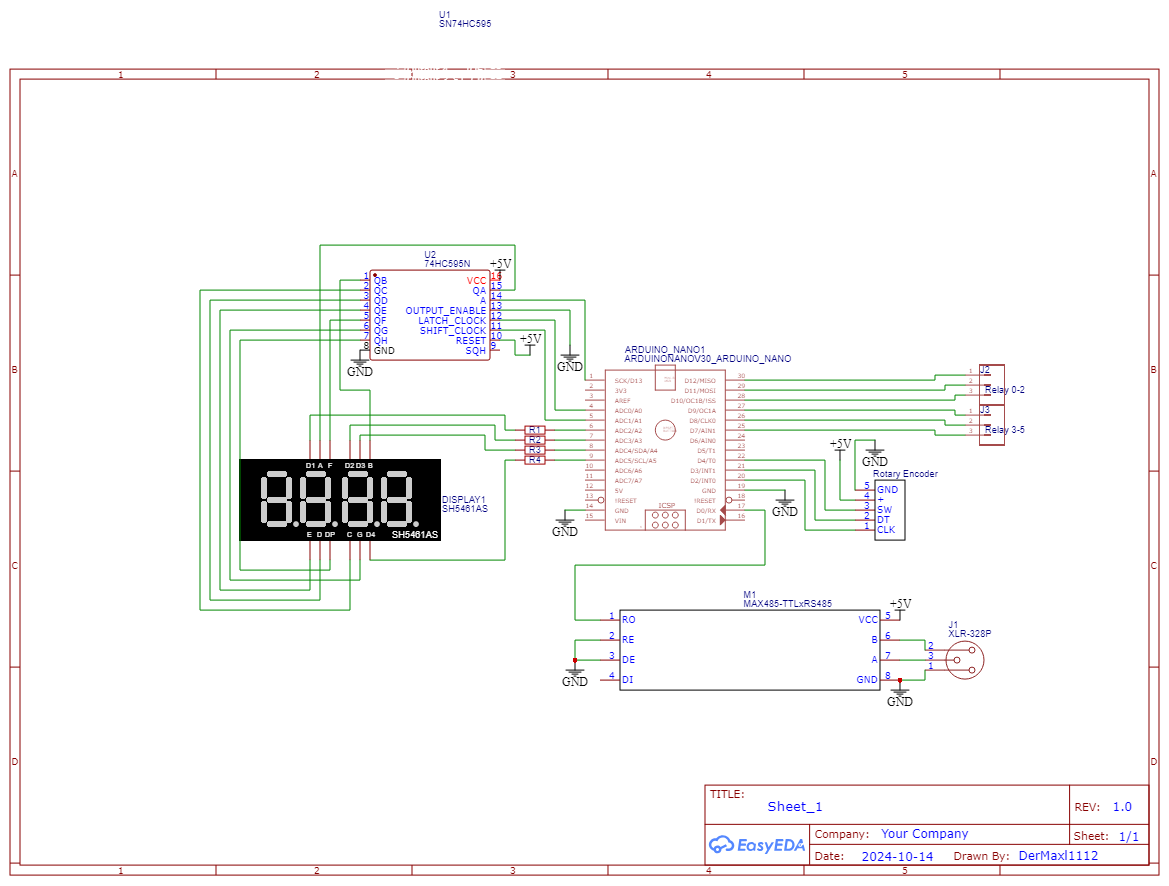

I'm working on a project to control relays using DMX and display the addresses on a 4-digit 7-segment display. The first digit indicates which relay address is currently selected, while the last four digits show the corresponding DMX address. I plan to use a rotary encoder to change the address, and pressing it will cycle to the next relay.
My setup includes an Arduino Nano, a MAX485 module for DMX, a SH5461AS display, and a SN74HC595N shift register as an I/O expander.
The DMX communication and display are functioning correctly, and the rotary encoder works well too—until I uncomment Line 57 DMXSerial.init(DMXReceiver);. Once I do that, the rotary encoder fails to detect any rotation, although the button press still works fine.
I'm having trouble pinpointing the issue. Could this be related to hardware timers or interrupts? Any insights or suggestions would be greatly appreciated!

Yes! But we need the following:
  • Annotated Schematic: Clearly show all connections, including power, ground, and power sources. This will help us understand your circuit setup and identify potential issues.
  • Technical Information Links: Provide links to technical documentation for each hardware component in your setup. Avoid links to sales sites like Amazon, as they often lack the detailed specifications we need to assist you effectively.
Why Do We Want This:
We can’t accurately assist without knowing the specifics of your setup. Clear, detailed descriptions will allow us to offer the best help possible. Without this information, diagnosing and solving your issues will be much harder.
What does the compiler show for available memory?
The sketch uses 2958 bytes (9%)
The global variables use 603 bytes (29%)
From the DMX library file...
#define DMXMODEPIN 2     ///< Arduino pin 2 for controlling the data direction is the default value.
Hardware interrupts on the Nano are pins 2 and 3. Maybe free those pins and assign clock and data to 5 and 6?
This should be the schematic.
I tried that and it did kind of work. The i tried pins around and found that CLK = 4; DT = 3; SW = 1 works perfect. So thanks for the help, Pin 2 was blocked by the library.
