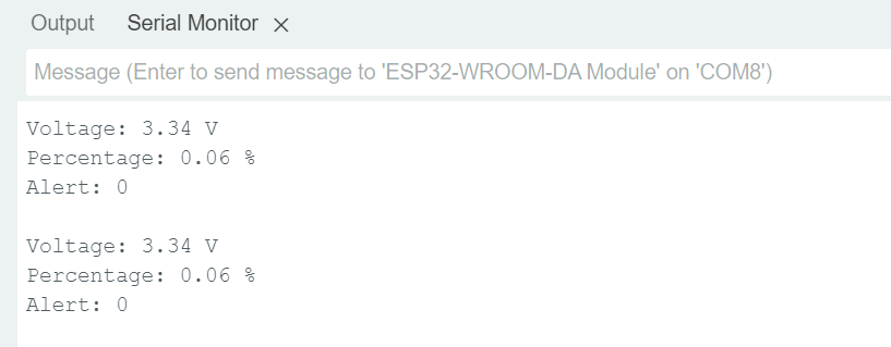

I'm trying to monitor my state of charge SOC percentage of my lipo battery (3.7V 2000mah) with the use of a MAX10748-G Fuel Gauge connected via I2C. Custom PCB with ESP32-Wroom module.
When using a simple example script to print voltage and SOC% in serial (Arduino IDE) i'm getting a strange constant voltage of appr. 3.33V and a SOC% of 0.06% while Lipo is fully charged.
Any thoughts what might be wrong or causing this issue? (e.g. bad soldering?, I already tried 2 PCBs resulting in same issue).
I would expect a voltage around 4.2V and appr 100% SOC.
PCB Schematic (part of it) attached.

Don't know if it's important, but the datasheet of the MAX17048 says to power VDD directly from the battery (page 15), not from 3.3volt as you did.
Leo..
