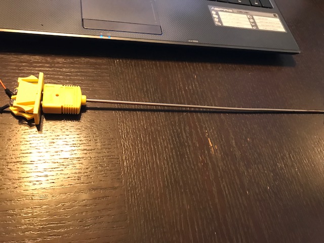

Hello all! I'm in need of some assistance. I'm reading temperatures from a k type thermocouple from Omega (attached below) using a MAX31850. I'm getting temperature values using the onewire library but I'm having trouble extracting one of those temperatures so that the extracted temperature can be compared with the changing temperature readings (in order to turn a heating source on and off). Would anyone mind taking a look at my code and show me what I'm doing wrong or what I could be doing better to improve performance. Right now it displays the temperature and when I push a button it "saves" that temperature but only for a few seconds (or not at all). I've also tried using the dallastemp with onewire library, but that gives me incorrect temperature readings. I have green and red LEDs to act as the power supply turning on and off.

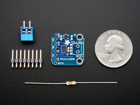

Looks like you have the TC connected with copper jumper wires, that can introduce reference junction errors if the TC and MAX31850 are at different temperatures, you need TC extension wire (type K) if they are far apart. Have you checked this link?
Thermocouple Amplifier with 1-Wire Breakout Board - MAX31850K : ID 1727 : $14.95 : Adafruit Industries, Unique & fun DIY electronics and kits

Thank you for your response and I apologize for the late reply. I believe my error lies within the copper jumper wires. Makes sense now. As for the button I already have a resistor in place would that mean I still use PULLUP? Regardless again I appreciate your help.
