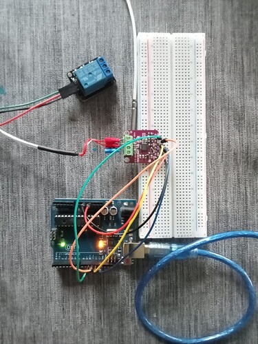

Do you have a relay module? Are you using a 3.3V or 5V MCU? Post the deets on the relay module. Is your project on a breadboard? Post images of your wired project. Describe how the project is powered.

yes i know it, but the c-language isn't my strongest point. The relay is 5 volts. here is a picture:
