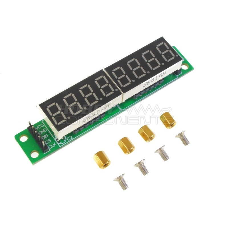

I've daisy chained 7 MAX7219 modules like this one. I'm using a separate power supply to power the modules with a common ground back to the Arduino. I'm using the LedLibrary and although I have setup 7 units in the code, I can only get the first 5 to display anything. Can anyone recommend a solution to this problem?
I also found that when the Vcc was also daisy chained I could only get the first two units to work then with >2 units the displays was random data. I got around this issue by feeding the external Vcc to each unit directly.
Looks like one of my MAX7219 modules is faulty stopping the buffer from going past the 5th module in the chain!

Mike, you can see what looks like decoupling caps in one of the images on the page Andy linked to.
However, you can also see that there is a space for a reservoir cap, but that does not seem to have been populated. Maybe worth soldering some 10uF electrolytics there.
I've added a 10uF electrolytic capacitor to each of the MAX7219 units. It fits quite nicely under the 7-segment.
Anyway, it hasn't been of much help. I'm still not able to light up all the digits.
I'm using an external power supply for all the 7-segments, 5V 4A, with common ground to the arduino uno.

Up to 8 or 9 MAX7219's all is displaying ok, and then with all 10 a lot of digits across all units aren't displayed. I read something somewhere about adding terminating resistors?
I would appreciate any further assistance. I need to get 80 7-segment LEDs lit up reliably so I can contnue with my overall project.

Tried it, displays 88888888 on unit #1 to #9 all ok, then on the 10th it displays some digits and random digits on the units #1 to #9 go

My next suspicion (chip in, anyone else) is problems with the clock and latch lines. They have to feed all 10 displays in parallel, unlike the data line, which is buffered by each max chip. Can you connect the clock and latch lines output from the 10th display back to original pins on the Arduino? In other words, the clock and latch lines are connected at both ends of the line that runs through all 10 displays. While you are at it, do the same with the 5V and ground lines.

I connected the latch and CLK pins back from the 10th unit to effectively the back to the Arduino, along with the ground out being connected back to the common ground. This only resulted in 2-3 units showing all 8 digits and nothing on anything else. Then a little experimenting resulted in finding that I only needed to connect the ground out from the 10th unit back to the common ground plus the CLK out pin back to the Arduino. This works brilliantly.
