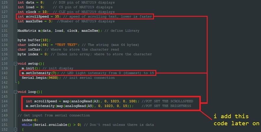

1-) i added two 10k potentiometer to breadboard and added code to IDE to adjust scroll speed and brightness.
POT's are works but problem is; when you adjust the POT, scroll speed or brightness on the MAX7219 doesnt change until next loop.
İs there a way to adjust instantly ? so i dont have to wait untill next loop of code ?
This is my POT added code later on
Yes read the pot so that you set the speed with every update, not just at the start.
Grumpy_Mike:
could'tn you explain on my code ? which part should i change with what ? im not expert like you. Explain it, just like explain to a stupid.
This is the line that sets the scroll speed variable.
scrollSpeed = map(analogRead(A1), 0, 1023, 0, 500); // speed of scrolling text, lower is faster
This is the line that sets the speed by delaying for a specific amount of time:-
delay(shift_speed);
So everywhere you see this line you put the line:-
before it.
@OP
Check if there is any immediate affect in the scrolling speed by doing --
1 Comment out the following lines in the loop() function.
//scrollSpeed = map(analogRead(A1), 0, 1023, 0, 500);
//delay(100);
// clearLCD(maxInUse, scrollSpeed);
2. Modifying the following line in the 'printCharWithShift()' function as indicated.
delay(map(analogRead(A1), 0, 1023, 0, 500));//shift_speed);

Yessss sir you made my day thanks for the help that solved my problem.
